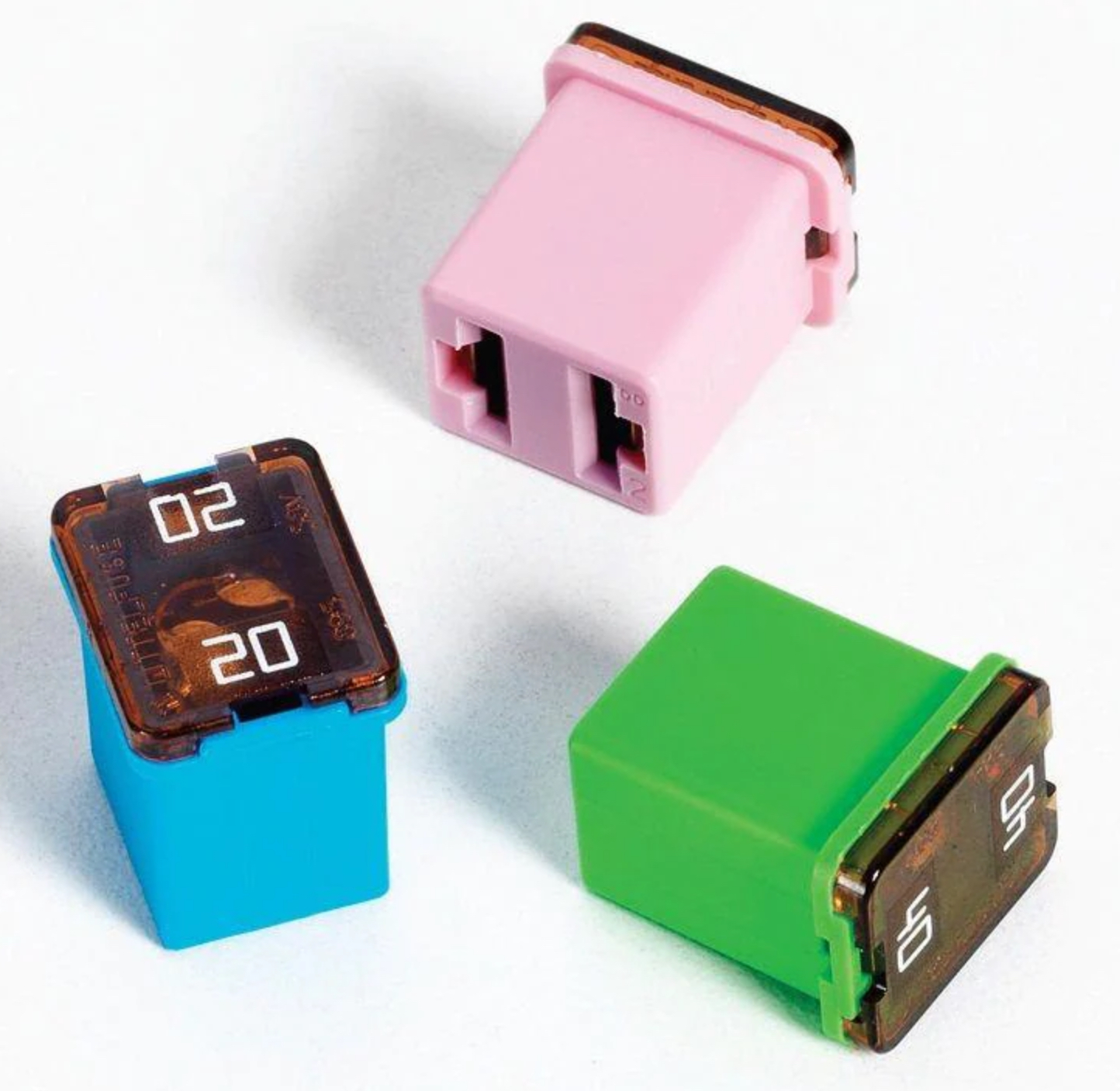

Just realized that the JCase ones here are not the low profile ones used under the back seats. They are twice the lengths. ;(
Are you saying Low Profile JCase Fuses (895 / PAL Fuses) are not the correct description for the fuse or you bought the wrong version?
JCase fuses can be normal size and low profile.
I always assume mistake in my side. Also naming here seems different and me searching for 895 returned nothing. Found it in some product documents though, so expected to be good.
The ones I bought after pulling one in the back are these here:
The ones used in the front are these:
So the connections sitting deep in the fuse box, I assumed the low profile ones do not fit.
Top image are low profile fuses, bottom are standard size JCase fuses. I believe only Low profile are used in the INEOS in two fuse boxes, but we have never had any confirmation from INEOS itself (and that will not change). EDIT: JCASE Low profile are used in the battery fuse box, and the longer JCase used in the cockpit fuse box and perhaps the under hood/bonnet fuse box. I am still trying to work it all out.
There is a deliberate lack of fuse information from all the car brands.
Well. So I confirm the EU Diesel version is using the regular ones in the fuse box next to the steering wheel. ;)
