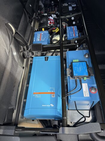

I am going to leave the cover off when this installation is finished so I can easily access everything. I have removed the rear seats and will install a hard floor for packing with access panels cut in.
