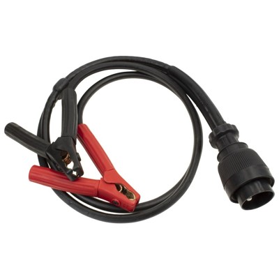

I keep wondering about those theoretical values.
In practise, the jump leads in the picture were supplied with a 15m coach ex works. They did the job for the bus no problem from what I know - and have certainly done it for me for the past five years.
We jump started anything with them. Once, a 3l BMW diesel wouldn't want to fire up and the jump leads were used for about five minutes, more the less continuously, until they got the engine running.
Cables are 50mm2 and 2m in length.
Jump starting a small engine draws what, 200-300A..?..the 2kw starter motor of the BMW was more like 400-500A I guess, and a truck/bus engine starter can be inxs of 1000A I´d say.
After a few minutes of starting, the cables got a bit warm, ts it...
Running a winch of a NATO socket is equally uneventful. Done that for ten years in the sand, without a single failure..like this Ramsey-type 5000lb worm gear winch.
The "NATO wiring" saves a lot of headaches and money in my book. What has been good for the military for decades, will outlast any consumer or even industrial grade stuff.
Personally I can't understand the desire for conversions to Anderson, once you are used/familiar with NATO, you´d probably want to convert your Anderson gear to NATO rather then vice versa.
Correct me if I'm wrong, but Anderson was originally a product for industrial applications and was only later adapted by enthusiasts for automotive use..?
I know, there are a lot of trailers in certain parts of the world with Anderson. Well, maybe they all get converted, eventually...:). After all, you guys are getting used to the 13-pin trailer sockets too...
Those are exactly the jumper cables i am after !!! If i cannot find a pair i will just chop up a new pair and stick a nato plug at the end !

You better, they cost an arm and a leg, $250-400, or more, depending on length and diameter, like those in 35mm
That’s what we did 15 years ago! Plus an NATO plug under the drivers seat of the Defender to provide an extra short cable to the battery.

🤔 I just bought a NATO plug and cut of the crocodiles from one end of the starter cable.
Let’s hope the wiring and fusing of the rear NATO socket will allow the sort of amperage needed for jump starting another vehicle now that you have cut the crocodile clips off.
I just copied and pasted this info from a jump lead supplier website in the U.K. -
For most standard size cars, a set of cables rated for 400 amps will be sufficient. More powerful vehicles such as trucks and SUVs will need somewhere around 800-1000 amps in order to turn over the engine.
I cut it long ago for my Defender, so I don’t care to much. On the Defender I just wanted to have a possibility to jumpstart someone without removing my seat. I have another jumpstart cable with both crocodiles still on both sides.
