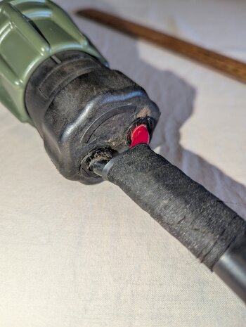

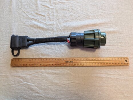

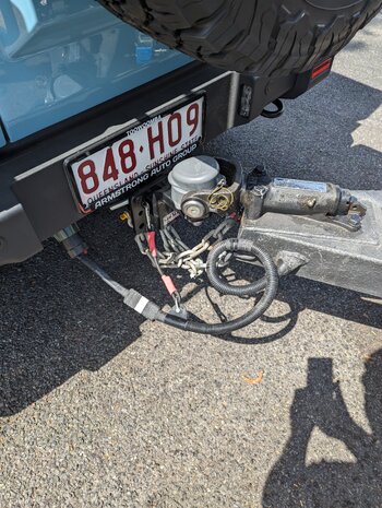

@Cheshire cat I think you have seen my adapter in this post. It wasn't the first adapter made and I'm not claiming it's the best but I learned some things doing it and since. Sharing again as part reflection and part summation of ideas from others.
  1. Your plug will likely have 35mm2 contacts. That's the size of the crimp/solder pocket in the wire side/back of the contacts. There is also a 50mm2 option.
  2. 6AWG (6B&S) cable is a good size to use. It has good mechanical strength for durability and the current capacity is well above the 50 Amp rating of the SB50 Anderson.
  3. If you're using the adapter for a trailer then think about the length of cable you use. Ideally you don't want the Anderson plug hanging vertically because it relies only on friction to stay connected. If you have a choice try to place the Anderson either up on your drawbar where it can be secured, or place it horizontally. I also added a tether to retain my trailer cable so it won't drag on the ground if it does come unplugged. If the adapter is just for a compressor or similar then the cable length doesn't matter.
  4. If you're dip soldering the cable into the contacts there is a sizeable gap to fill in. I made some copper sleeves. A simpler method is to cut a 35mm2 butt splice in half and use one half per contact as a spacer. Example. 50mm2 butt splices are also available if required.
  5. You will need to close the back of the NATO plug rubber gland to support the cable and add weather protection. I used 13mm barbed irrigation pipe stop ends. Example. I drilled a hole in the end of the stop for the cable. Make this a close fit and no sealants will be required. Add some heat shrink if you do want to tighten it up a bit.
  6. I recently added an Anderson boot to close the cable entry at the back of the SB50.
Current pics below.
