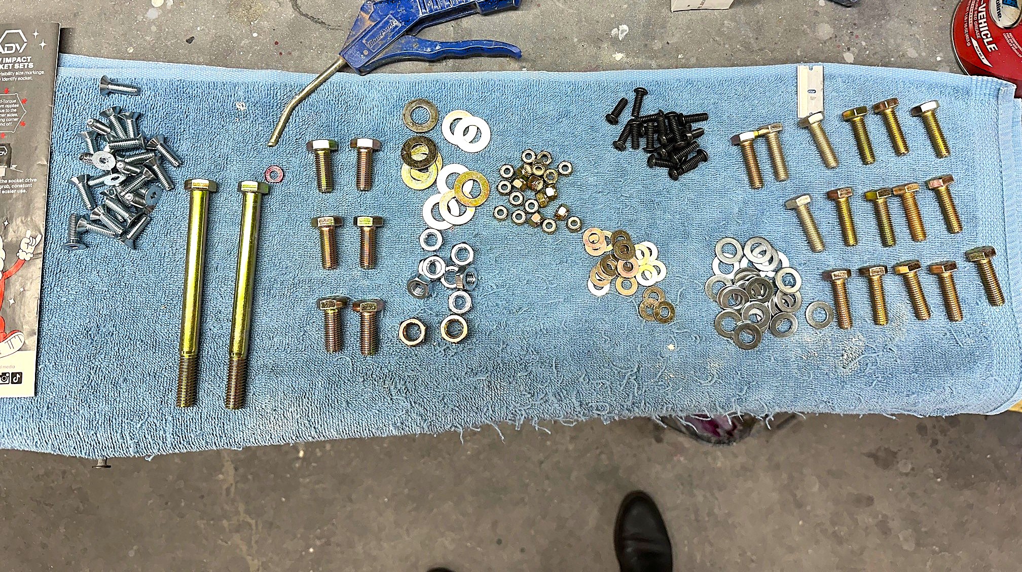

Received and installed my Dissent Offroad Grenadier Step Sliders yesterday. I couldn’t be happier with materials and build quality. The rails are 3/16” steel with 1/4” steel mounting brackets. They were shipped via UPS and extremely well wrapped. In foam sheets and plastic wrap. My only criticism is that the parts were not marked, so there was a bit of trial an error involved in getting the first one properly bolted to the frame. About that, all the tapped holes in my frame had rusted threads required a little cleanup with a tap and penetrating oil.
There were no instructions in the box, but they are available on Dissent’s website. The second slider went on easier than the first. It wasn’t intuitive to me that the sliders could be installed level or at a slightly pitched rake, which is facilitated via the spacer plates on the Rear Bracket. Also, you can adjust the depth of the step/rail from the frame, which I chose to push out to maximum.
Another little tricky bit was fastening down the top tread plate to the slider rail, which required a little dexterity to hold the nut and washer under the hole inside the angled outside edge. A dab of putty to hold the washer on the nut helps when you’re working with the small bolts.

My thoughts and experience exactly. Very well made and happy with the design, looks, etc.
Your picture of the fasteners and pieces was much better than what the instructions showed but still very happy with the purchase as well.
