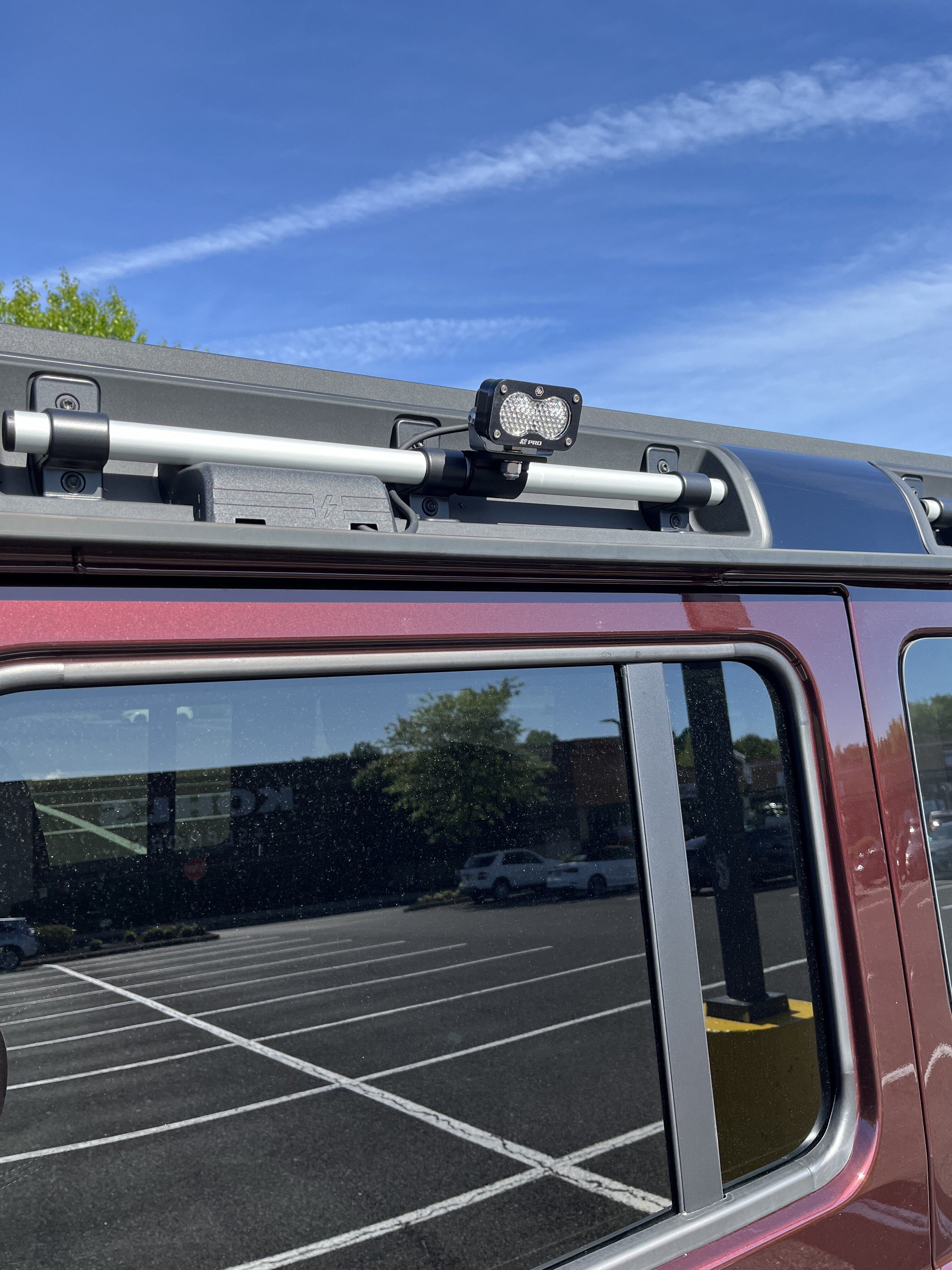

This is what I went with on the roof line. I am going to be mounting them to the Leitner 3/4 rack that is in route now.
FWIW - the ARB light and the KC lights look virtually identical.
Stedi cube light on my custom bracket. I needed to stay fully below the rack and still clear the door. Stainless bracket mounts to both top & bottom of the rack, rock solid and gets the job done.
I bought a Stedi harness, shortened it, replaced a DT with a DTP, then it was plug and play.
+1 for Stedi Cube.
I have one each side, bolted to bottom of Front Runner rack such that I can swivel them.
Very happy with spread & power of the light, esp. during camping.
