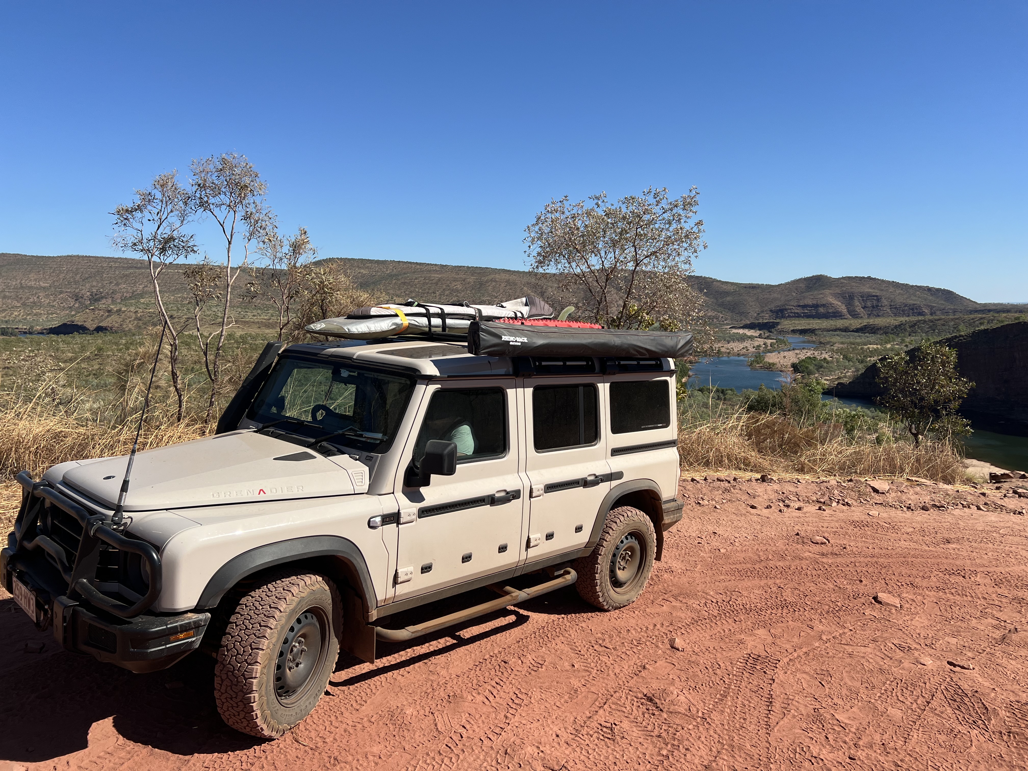

OUTBACK SHAKE DOWN CHANGES – ROUND 2
ABNTR4X4 Rock sliders refined
A metallic noise/rattle/squeak developed about one week after the installation of the rock sliders. Luckily before I went on my Outback trip.
The sliders were attached using plates secured by bolts; some bolts were fitted through a drill hole, others through a slot in the metal plate (to allow adjustments). The bolts through the slots were trying to pull the washers through the slot, so the washer became cupped letting the rock slider move.
After the initial install the mechanic had commented the bolts should be longer. After discussing the noise problem with the mechanic, I bought longer high tensile bolts (replacing the OEM galvanized bolts) and large square washers that were also thicker than the OEM washers. After jumping up and down on the sliders after the refit, the mechanic found there was still some noise. On closer inspection there were screws in the body work exposed after the trim was removed to fit the sliders. So metal was still rubbing on metal. The mechanic adjusted the position of the sliders away from the exposed screw heads.
Everything has worked well since the changes and no more issues arose in the Outback trip.
ABNTR4X4 rock sliders are great, but they needed some refinement for Australia (at least for my purposes). First, longer 50mm high tensile bolts. Second, larger and thicker square washers and lastly adjusting the sliders to avoid touching the screws exposed after the trim was removed (you could cut these screws off, but that was not my preferred option).

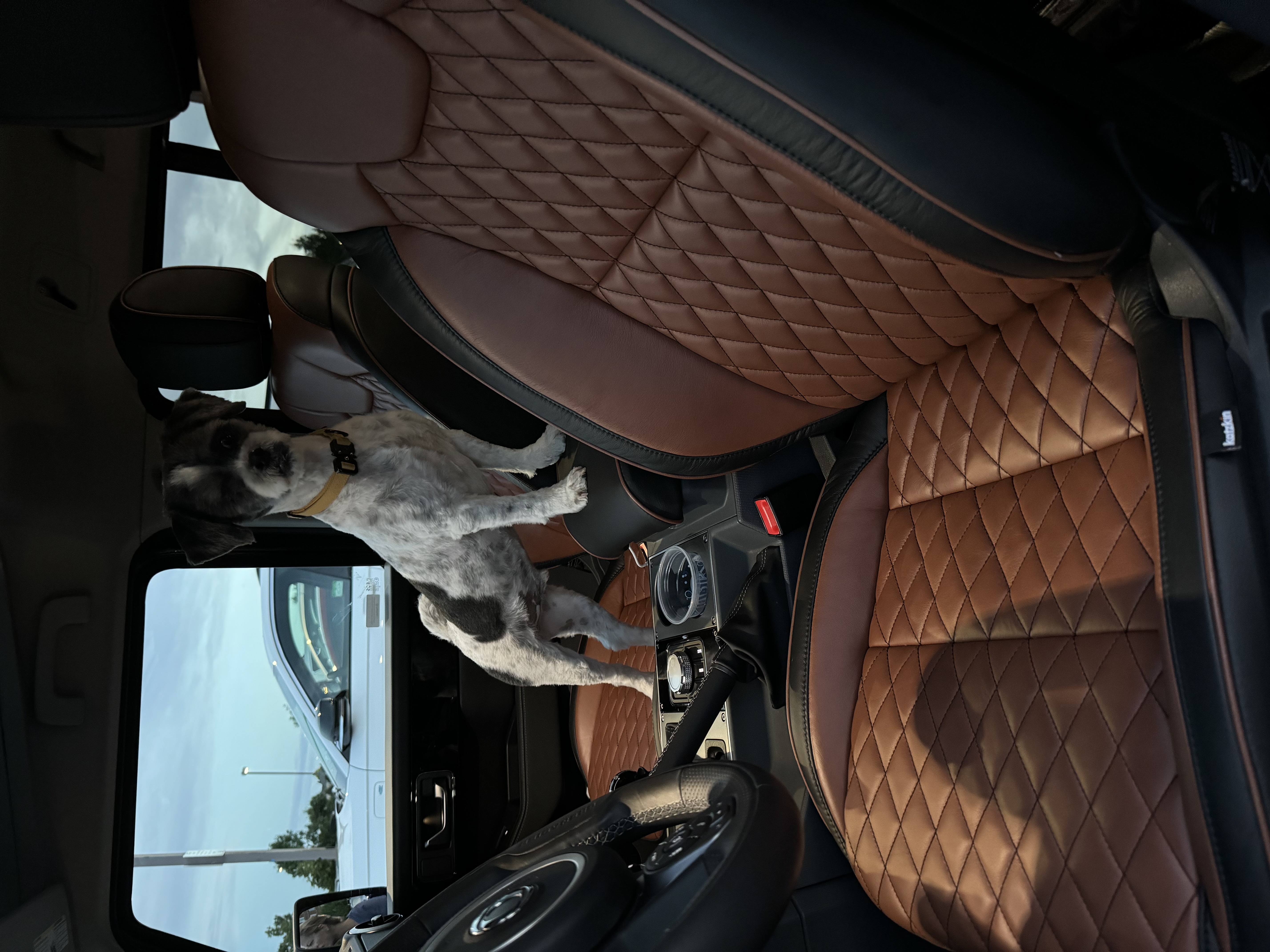

Picked up our Grenny from Red Nolan and went to Pikes Peak! Hitting some other trails before heading back to Texas. We upgraded the leather interior and installed new 285/70/17 KO3’s
