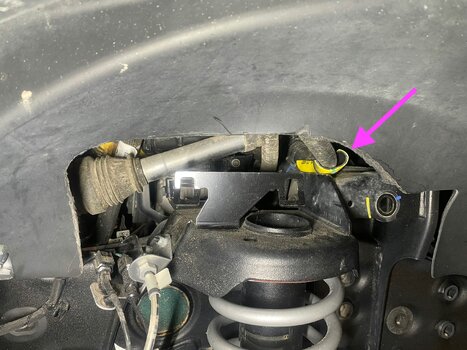

Just checked mine. It's similarly just floating in there but not quite as loose as yours. I identified another section where the black hose comes in direct contact with a plastic hard edge (the whole thing seems to be leaning on that edge of the air intake box in the arrow you see). I wrapped it with some gorilla tape to protect against abrasion. Second photo is from the front of the hose so you can see the numbers on it.

I also checked that tube but in my case it moved decidedly less. I fixed it anyway.
However, I found another tube interfering with a metal clamp... I'll post some photos as soon as I can.
Mine looks visually the same, but feels firm and does not rattle around like Adam’s video. I also have a clamp/support that connects to the fan shroud. MY24 VIN 71xx.
Mine is exactly the same. But look at that top hose labeled 406270. What is the base of that leaning on? On mine, it was leaning on hard plastic, which will rub overtime.
On mine the metal clamp lines up with the potential plastic contact point you mention. So, if there is contact, I lose plastic (not a hose).

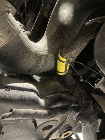

Upon further inspection, my hoses seemed well supported, until I checked them from below. My previous photos were takes from above. I ordered a box of these to strap the lowest coolant hose cross, where the most movement takes place. Don’t worry, I put some rubber between them to prevent chafing.
I need some of that for my unsupported pipes 👍🏼
