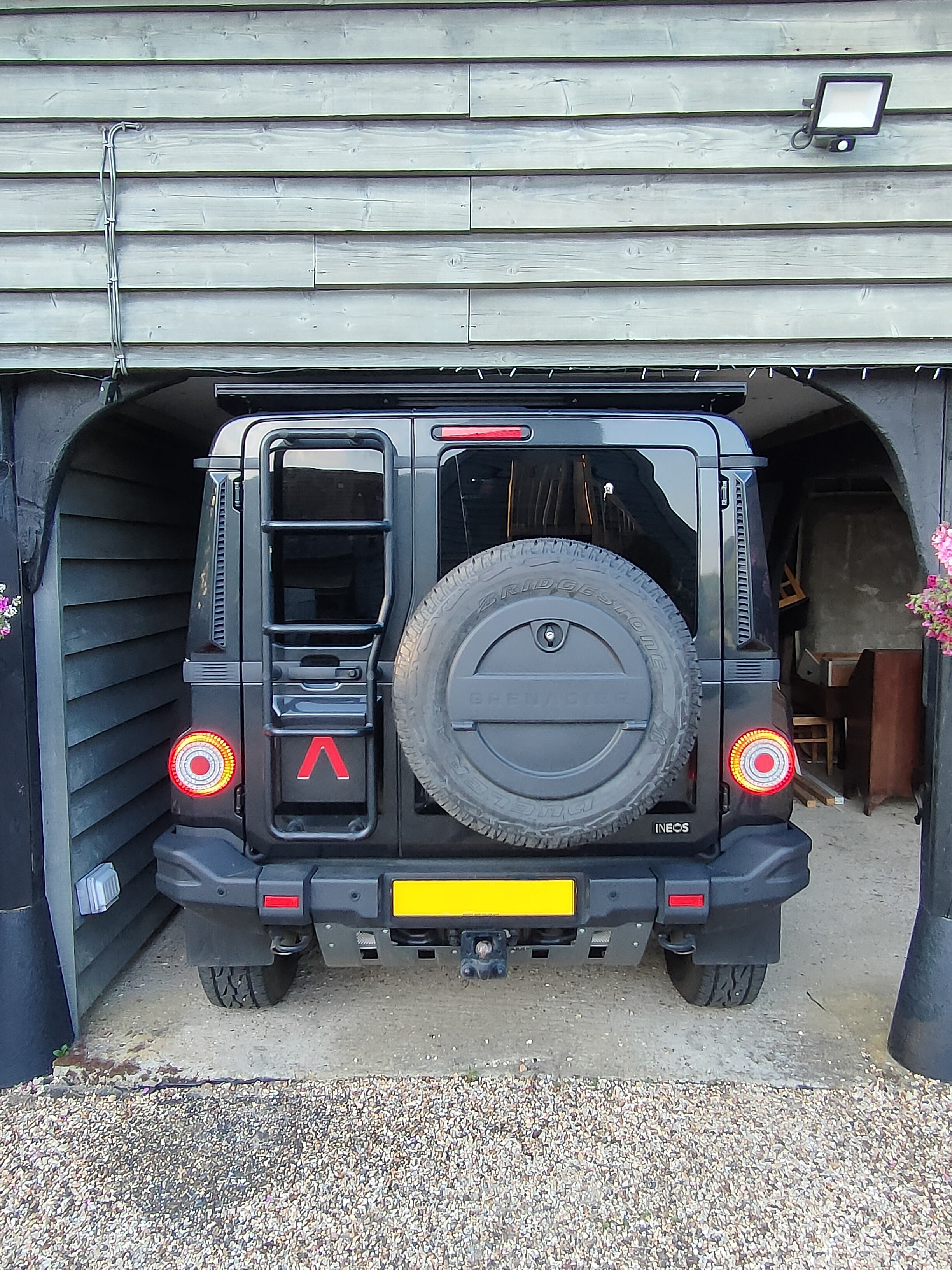

Hi Krabby. I'm curious to know if you've received your Bison Gear roof rack yet. If you received it already, have you measured the overall height of the truck with the rack? I'm researching different options, but my garage is limited to 84 inches. Any information is greatly appreciated!
The bison 3/4 rack adds 6cm to the overall height of the vehicle. The wind noise is basically nothing upto 50mph but beyond that you can slightly hear it but nothing serious.
