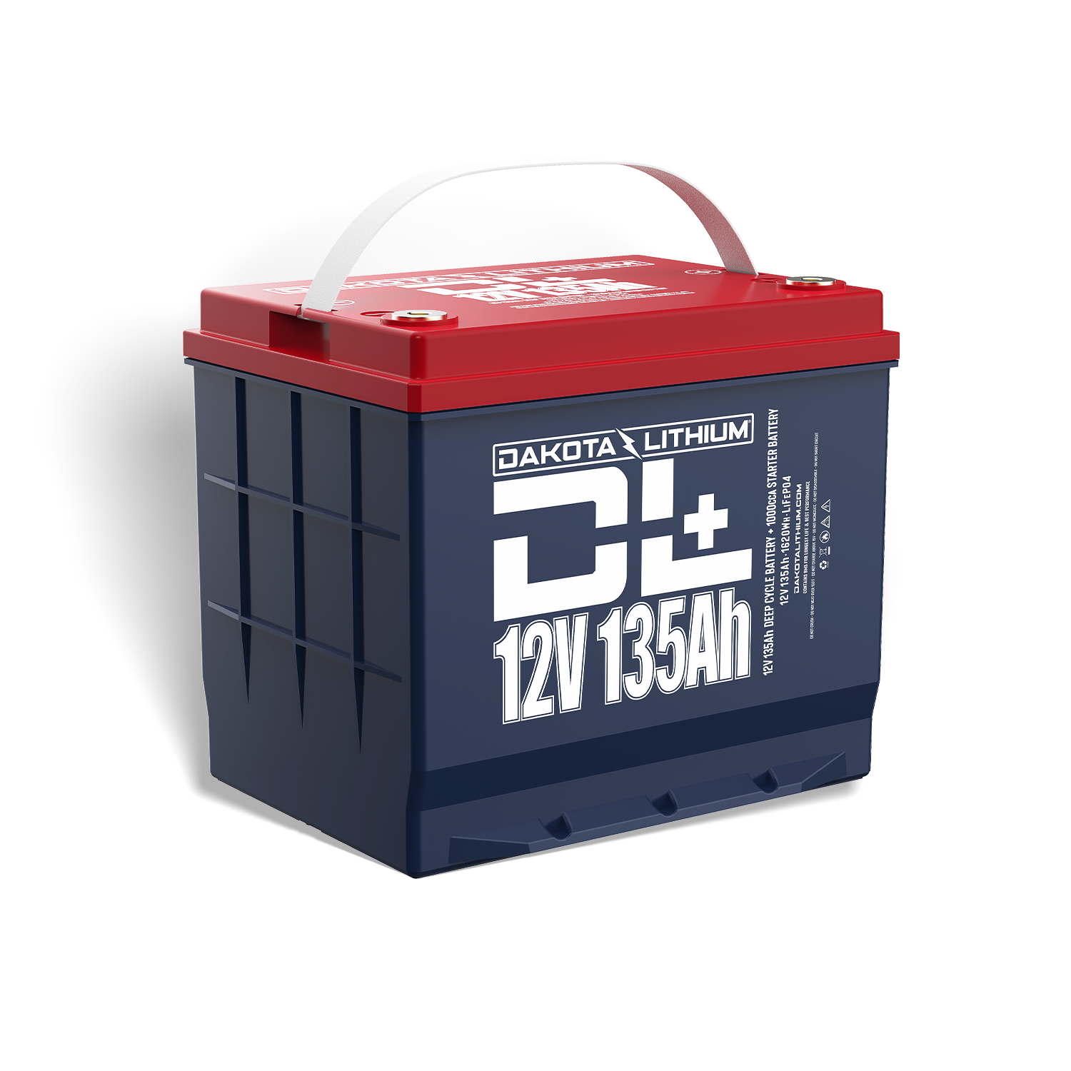

Would something like this work as a replacement for the service battery? A lithium Ion starting/deep cycle battery.
You'd need to check the height of the service battery/space but looks like it'd fit. I'd remove the Smartpass and use either a Ctek 250SE (20A), Victron Orion (30A) or a Redarc (25/40/50A), bigger the better. You lose start assist but a jump starter fixes that. The starter is less likely to drain anyway with no fridge running off the 12V boot socket, run the fridge direct from the lithium. You also lose the ability to power the fridge from the alternator while on the move via the Smartpass load terminal, but an automotive relay can fix this.

First I am no expert on the subject, however, I have been following this thread and have watched numerous videos on the subject, mostly posted by Australians, and best I can figure is a lithium service battery will provide significantly more runtime for accessories than the included second battery which it seems is primarily a backup to main starting battery. Therefore, I think a dual purpose lithium battery, which is also designed/capable of starting the vehicle, will be a better option than the included second battery or a lithium battery which is not able to start the vehicle. My plan is to have a professional install this type of battery and run all my accessories, including a refrigerator/freezer, and some of the power outlets on the roof off the service battery isolating the starting battery to simply start the vehicle.
