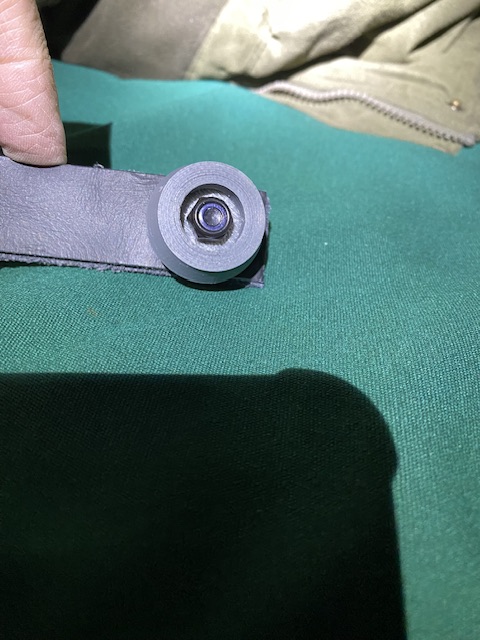

Riffing on the @AnD3rew butt plug here is a simple plug that takes an M6 bolt. Can be used to mount anything your heart desires, the bolt can insert from the rear (a JCB bolt as shown is ideal) or you can insert from the front and use up to a 16mm washer and nut to secure. If you are worried about the strength of the 3D printed plug the nut & washer would capture the load if it failed (which it should not if printed solid or with high infill level, it feels strong as). Bolt in picture is 30mm long, here is the file:

Thank you, thank you and thank you! Exactly what I needed. I don't know what program to use nor how to use any CAD / etc programs, so I'm at other's mercy and generosity for what I can print.

I just had our STEM teacher print one off for me and I think these are perfect!!! I'll probably do the leather strap thing from etsy. What color best matched the IG saddle package? The "saddle" leather shown seems too light.
