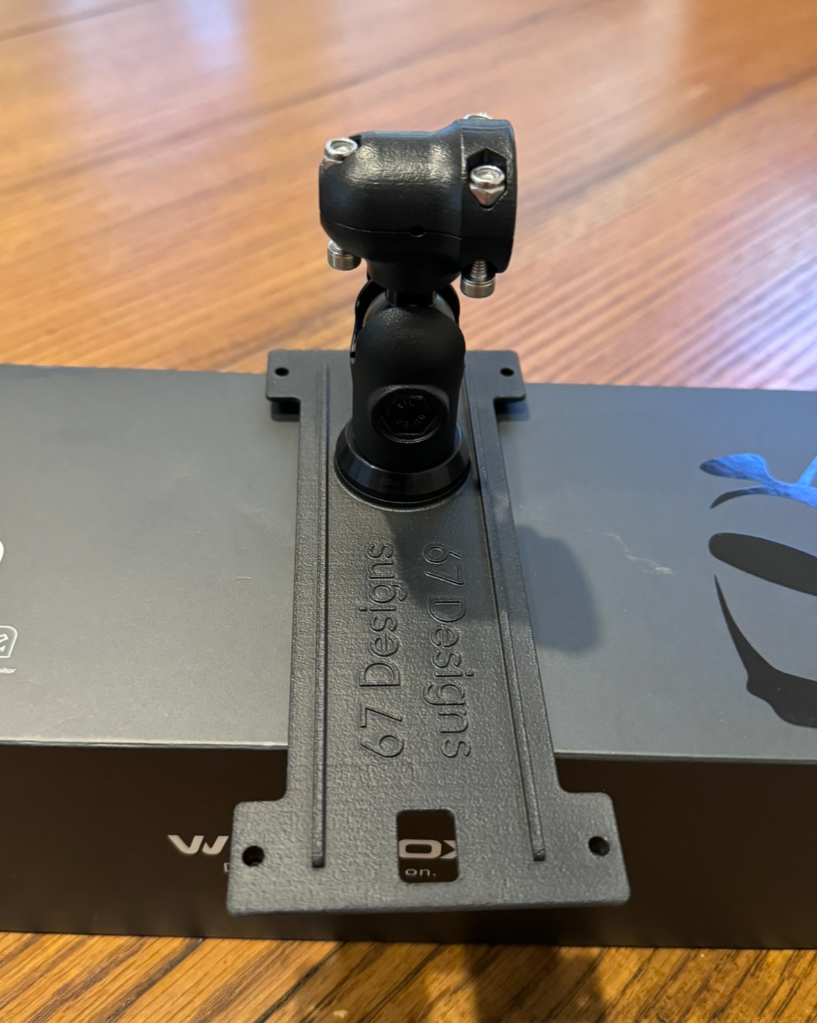

67 designs mount for the G900. Used but in like new condition.
