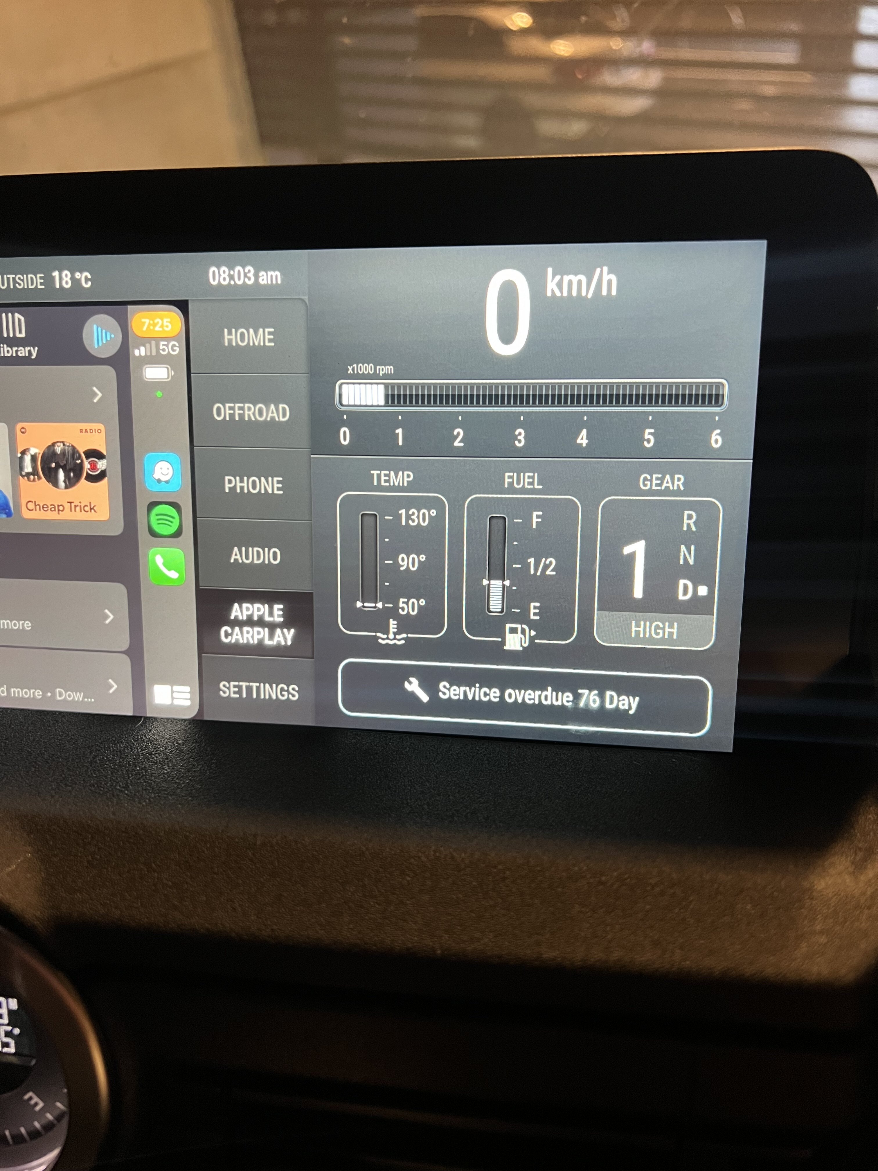

Hi all,
My dealer is awesome and will have a look at this for me tomorrow, but I thought I’d see if anyone has experienced this before.
I had to go to an aunt’s funeral about 170km drive this morning. I hadn’t driven the grenny for about a week or so.
Started it this morning and noticed two things.
I has a “Service Overdue 76 days” warning light come up, and the clock said it was 8-03am. It was in fact 7-26am. The time reset to the correct time after a restart. After a two hour drive we progressed up to 215 days service overdue.
Anyway. Funeral and wake done, and it’s time to head home. Start the car up, service notice still there, but so is the Check Engine light on in the christmas lights panel.
In addition to that, I can’t toggle through the information panel (L/100km, adblue, range to empty etc) and cruise control doesn’t work.
No issues driving the 200km home.
Probably just a gremlin, but any thoughts, similar experience??

Hi all,
Thanks

Hi all,
Thanks
Following the s/w upgrade to version xxx364001946, the display on my Trialmaster later degraded in response the toggle switch on the end of the indicator stalk: e.g. the numbers would freeze, the "categories" were slow to change (from distance stats to fuel stats etc) and the reminder for service was 1800 plus days and counting and appeared every 6 seconds for the next 10 -15 secs.. . somewhat inconvenient... also, the cruise control was dropping out occasionally on a long trip.
The s/w was updated to xxxxx 689002940 a couple of weeks ago (at the 12m service) and the display is now stable and the toggle switch operates consistently.
I've not had a chance to check the cruise control on an extended drive.
FWIW...previous posts re. the cruise control have been related to full/partial failure of a "gateway module" which also affects power steering.
All of the above are "known" issues to Ineos....
