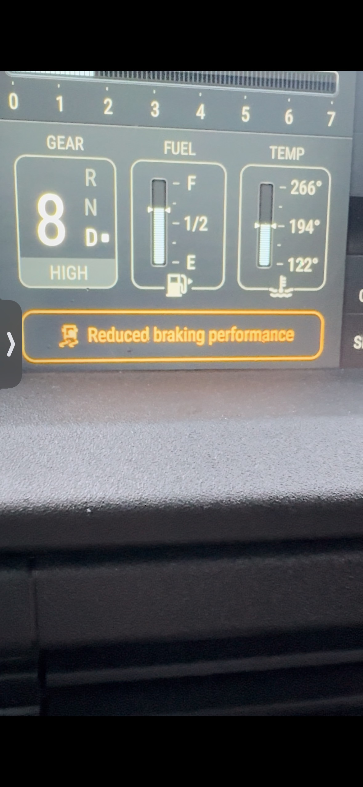

I am having the same issue, it popped up while driving the other day, when I got home I cycled engine off and on but it remained. Next day it was gone then reappeared ten minutes into my drive..🤷‍♂️
Intermittent set of warnings random, uphill assist, downhill assist, ESC unavailable, reduced braking performance & cruise control doesn't operate. '
@m18rus was there any identified cause for this issue? I am experiencing the same thing
@jkloy did the dealer/agent find a cause for this error??
I did not ask the dealer. To be honest, after this error did not happen since a few months, I simply forgot about mentioning it when I had my first service at the dealer lately. Knock on wood.

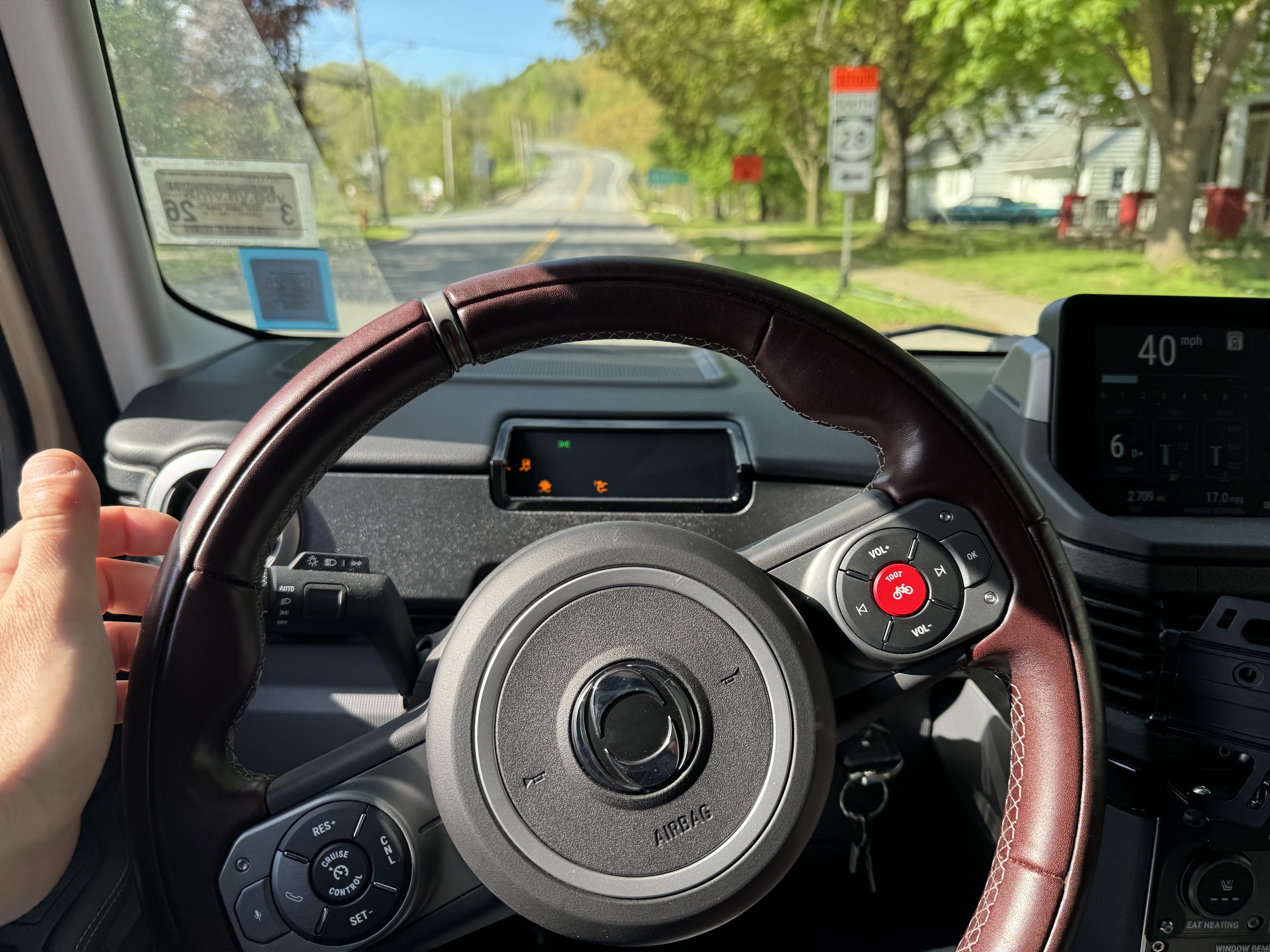

This started showing up about a week ago, at first it would pop up about 10 minutes into my drive, but eventually it was on consistently at initial start up of the vehicle. "Coincidentally" this started around the same time my steering wheel itself was beginning to get out of alignment. (Subtle at first but then dramatically worse, as depicted below where Im tracking in a straight line)
I checked below and it turns out the adjustment collar on the passenger side was loose and could be moved by hand, so I started to suspect that the steering wheel alignment was the cause for these alarm bells.
Now to be clear, I had an alignment done by my local shop 2700 miles ago and they owned this problem and immediately got me in for another alignment and proper torquing of the lock nuts at no cost, however the alarms persisted at start up afterwards and the next day. So I made an appointment with Curry Service Dept, and discussed this with them, they said if it persisted it was likely a wheel speed sensor (He said they have done two with these same sets of alarms for faulty wheel speed sensors)
Then, as suddenly as it showed up, these alarms were simply gone and not to be heard from again now for the past two days/100 miles.
My suspicion is that the computer and sensors had to "Learn" that things were back to normal before committing to saying so.
I know this is a long winded post about a simple problem and solution, but I thought it was important to share that this was something that seemed like a simple electrical gremlin at first but in fact was seemingly responding to something erroneous, AND it ultimately did what it was supposed to when the problem was rectified (albeit after many miles of drive time).
After my lift install, but before I got an alignment I had the same warnings. Once I had a proper alignment they have not returned.
Truck gets unhappy when something reads out of tolerance with the sensors.
