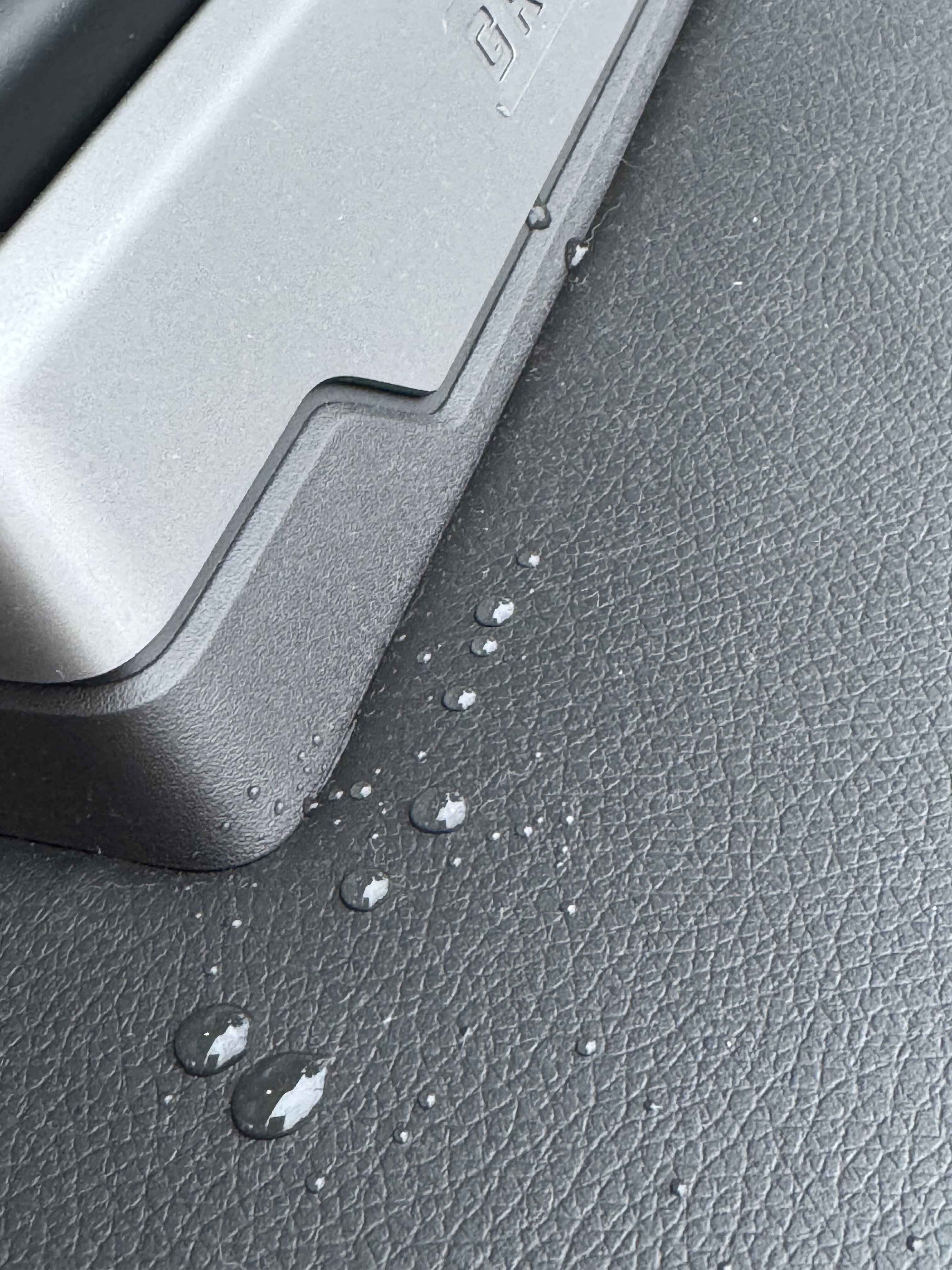

My Grenadier just last night showed droplets on the dash under the camera/rearview mirror for the first time after 9 months. Bummed for sure...
I had the same issue. Turns out mine was leaking through the antenna. You should have the dealer check the safari windows and antenna.
