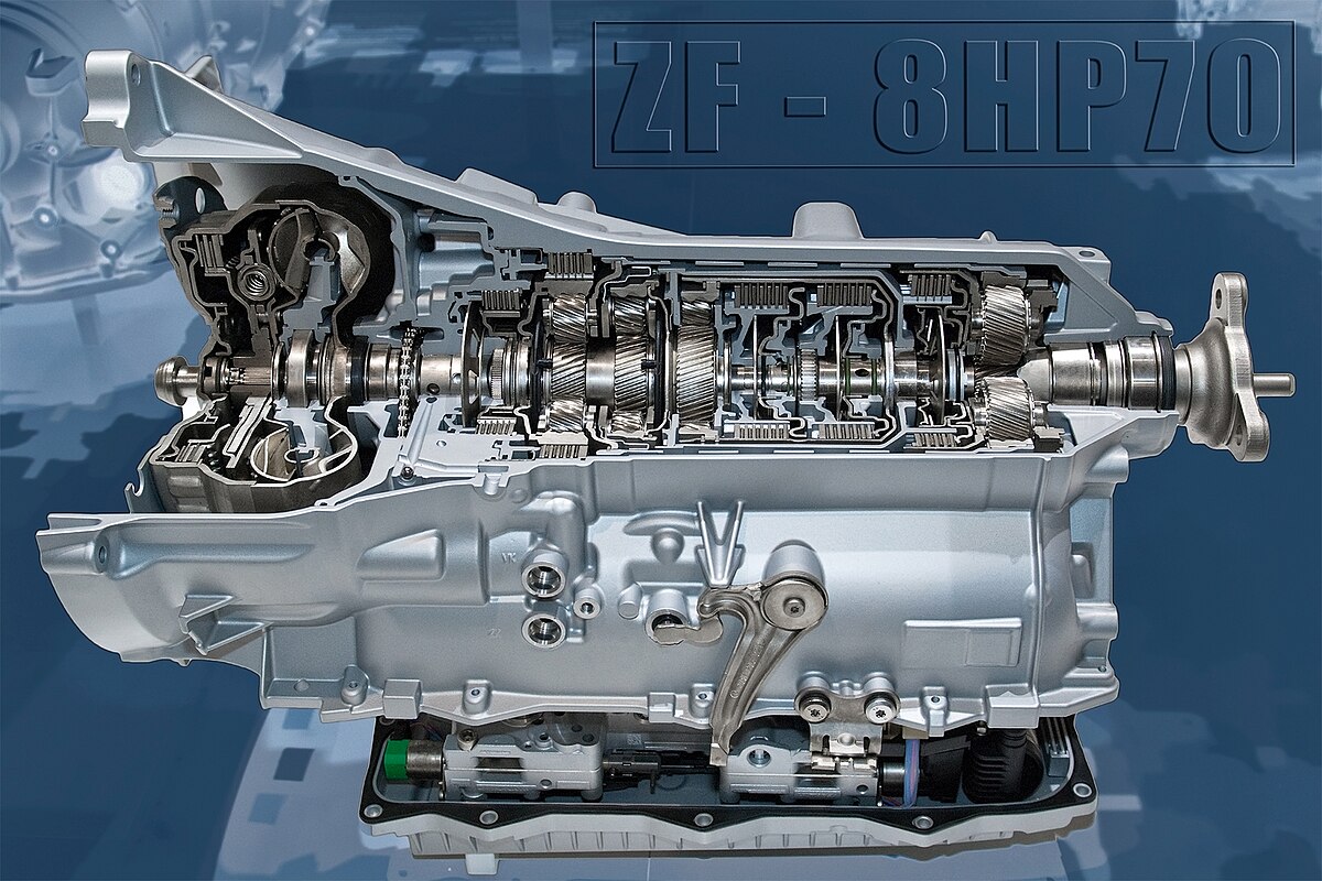

I would also like to have the exact data / internal data. I saw the two gearboxes disassembled in a workshop, and I noticed the larger and reinforced components. It is also noticeable in which vehicle classes the different transmissions are usually installed. I also wonder how the ZF 8HP51 is sufficient for a car like the Grenadier. In the weight class, I had even expected the 8HP90 or even the ZF PowerLine, which is a heavy weight 8HP.

See post #35, or google "ZF 8HP" - plenty of info on these transmissions. As the numbers of the variant go up (8HP51, 8HP55, 8HP70, etc.) they are built to handle more power. I think we can trust Wikipedia on this, but there are other sources if you look.
Sorry stickshifter, that data is (by far...) not sufficient to evaluate the differences of the 2 transmission versions. At least max input rpm, max output torque and max transmittable power is required.
Yes, that would be very helpful!
From just looking at the size of the components it is impossible to judge performance. At most, one can tell that the torque is probably higher with larger wheels and clutches, but not the power!
Got it. I was probably thinking of other posts on this topic, in which people didn't know that there were different variants of transmissions between the B57 and B58, so I was just pointing out that the diesel one can handle more torque than the gasser. Why are you looking for those specifications? Will this data be a factor in you deciding between the B57 and B58? Are you planning on tuning either of those engines?

ZF recommends a transmission oil change every eight years or 50,000 miles, and that's a job you can tackle at home. For this DIY, we are using a service kit for BMWs. Although the kit is for the BMW 8HP45 and 8HP70, you can apply the same basic process to servicing every ZF 8-speed, regardless of the make and model.Oct 18, 2021
