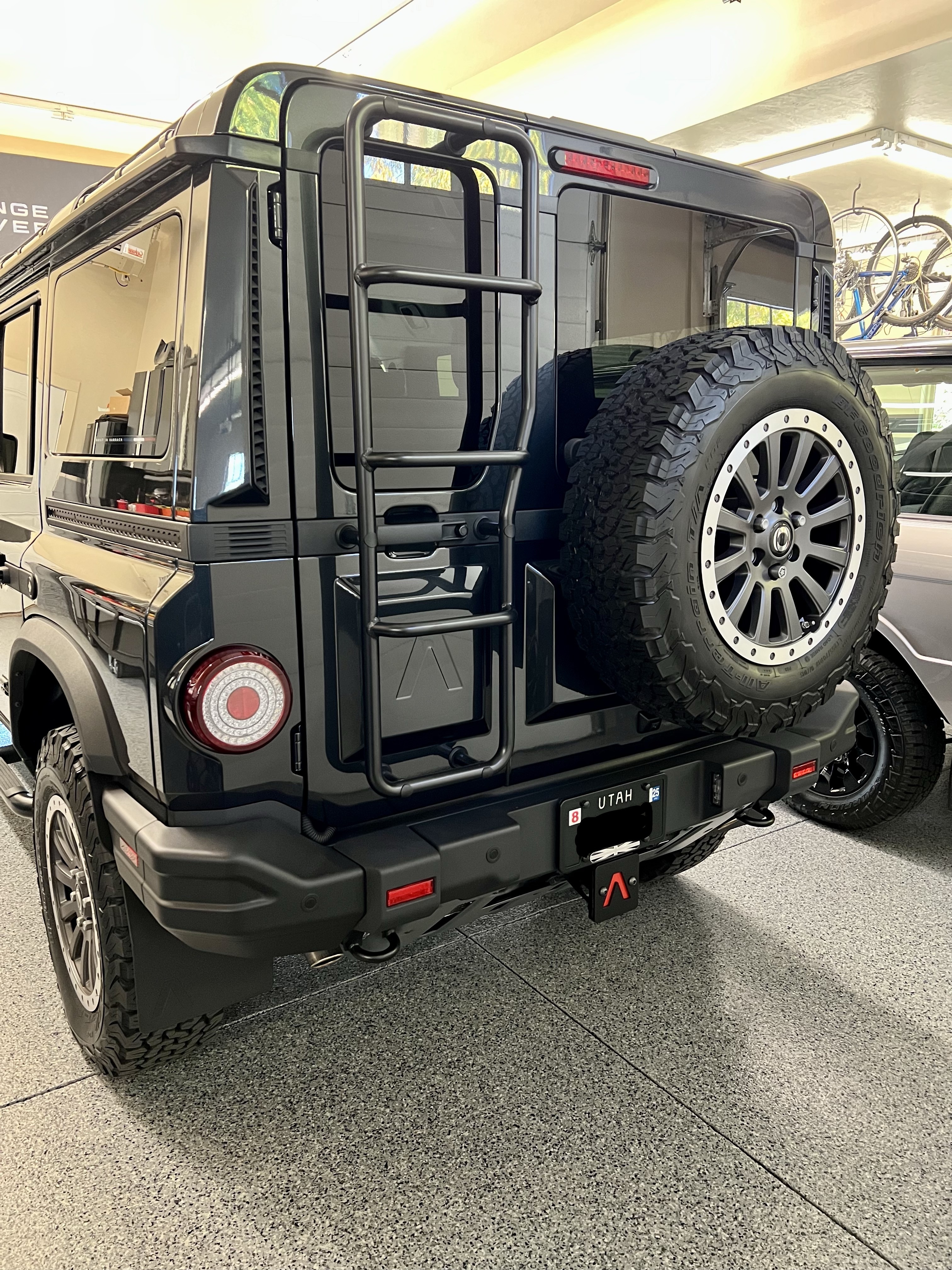

If you want a really pretty Tire relocation and 180 Degree flip so it faces outward the Agile Offroad is very sexy.
Didn’t like the look or quality of the plastic stock cover… flipped the wheel with the Agile kit and can now more easily check spare tire pressure. Plus less risk of scratching the face of the wheel trying to put it back on the mount when you are struggling on your own to lift it.
Wow - looks very clean, any miles on it?
