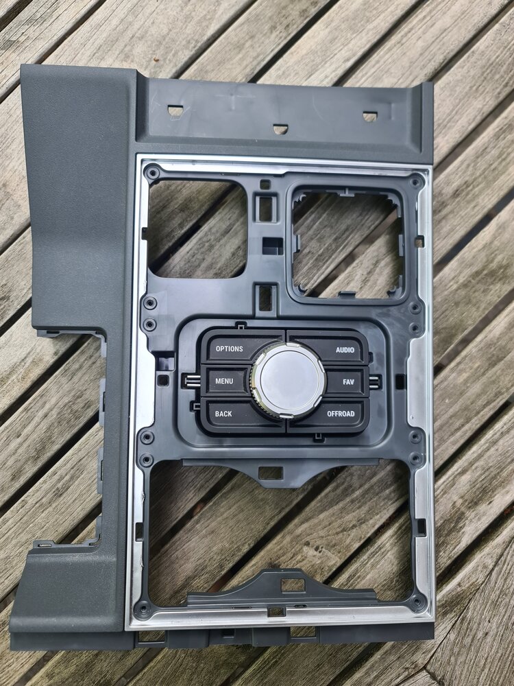

Hi Cheahire cat,
I couldn‘t wait untill next week so I copied your excellent idea today.
First of all you are right: it is a bit of a challange to get the hand in that area. The fact that all plastic parts inside — once the cup-holder is build-out — are sharp like a razor blade doesn‘t help…..as you can see in the first picture 😂😂😂
However, the spot for the USB socket is brilliant from my point of view. It looks like that it belongs there 👍🏻!
