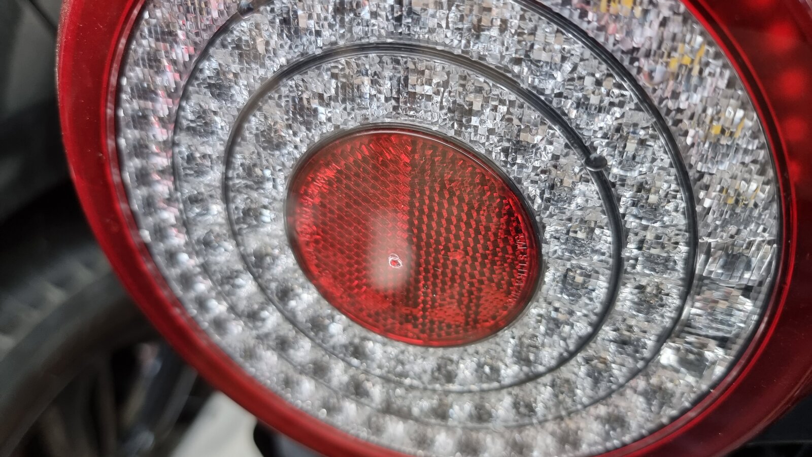

Looking at the rear lights I found humidity (which is ok for breathing cases when the car is not driven) but also a (maybe production related) plastic nipple right in the middle you could see and feel. Not a problem, but also not nice. The humidity should g away when using the lights, otherwise it is not acceptable.

Old school lights used to get hot.
The test is to dunk them in a river and see if the water level inside drops.

All lights breathe. With old bulb lights the housing were not dense so they could also breathe. Modern LED lights have valves which let air pass, but not water. So a good LED light can be drowned or they are at least safe for spraying water (depending on the IP protection level) without getting water into it (which would be fatal). However, by turning them on, and they get also very hot, the water should evaporate and pass the valve to the outside. When cooling down the light sucks air and humidity in which leads to light fogging. That is normal.

Yes as an owner of 7 classic cars including old Porsches (the benchmark of quality engineering , at least last century) I concur!
Hermetically sealing seems ideal, but it is not.
