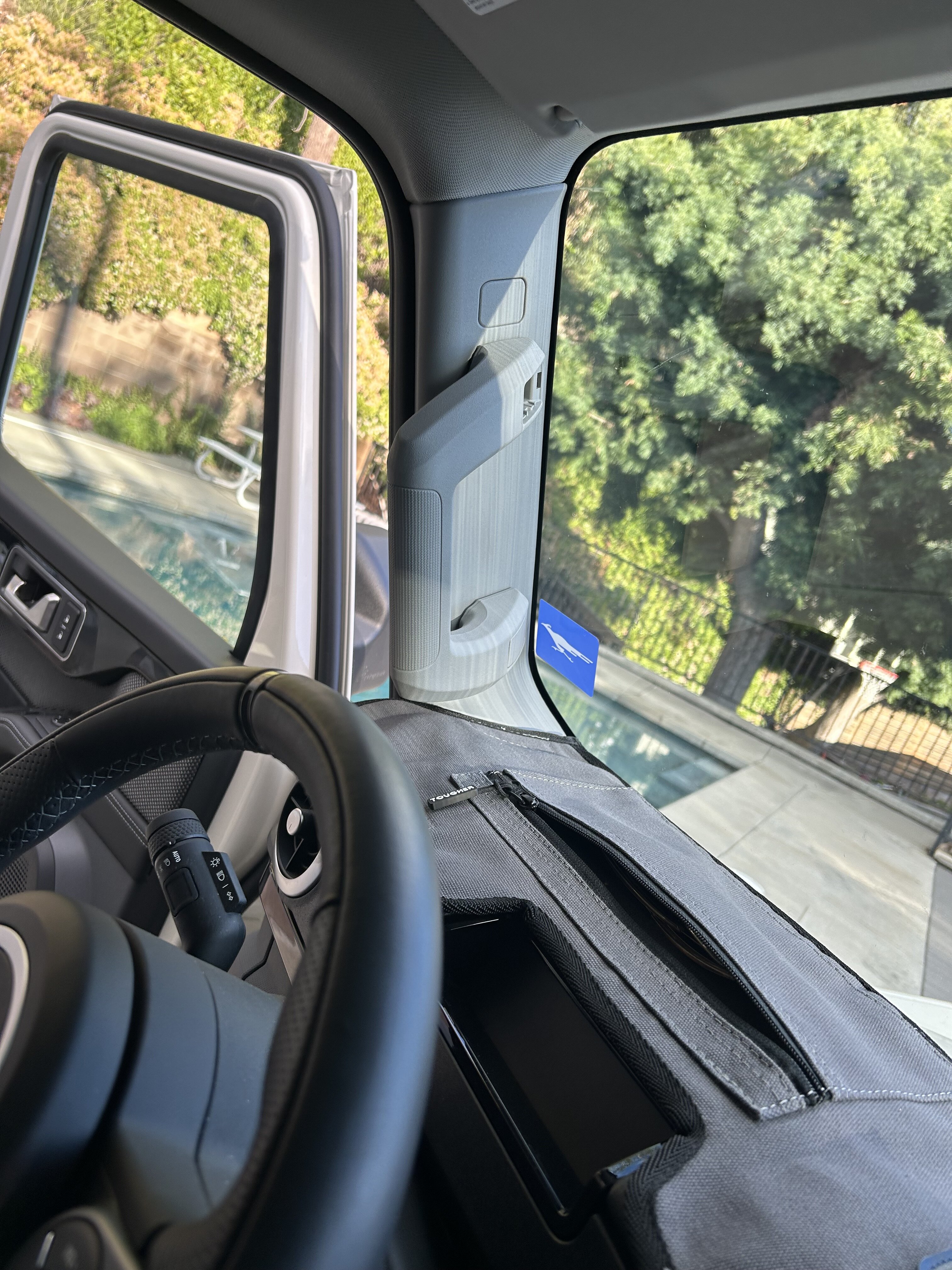

It is possible to do this on a US Gren.
Here is the picture.
There are two ways to do this. The right way and the hacker way.
Right way is to order the grab handle, screws, the two screw cover tabs and the left side A Pilar trim piece with the correct left hand grab handle cut outs from the right hand drive model vehicle. Install all parts and you have it.
Unfortunately, the right hand drive parts are not available in the US. So you can order the grab handle, screws, the two screw holes covers and then will need to cut the trim panel to fit the handle in the left side of the vehicle. Relatively easy to do.
Here is the part that bites you. Those little plastic tabs that cover the holes for the bolts on the grab handle. The pair costs more than the grab handle. Why, I have no idea. Makes zero Sense to me. Maybe someone can explain it.
Disclaimer: Someone also brought up a good point about interference with the A Pilar airbag. I think this is something that needs to be considered for safety reasons. Don’t do this unless you know what you are doing and understand the operation and safety features of your vehicle.
Well done, I don't think there shouldn't be an issue with the airbags one would think, as they look the same once the interior trim is removed, the only difference I could see is one has L and the other R with corresponding colours.
