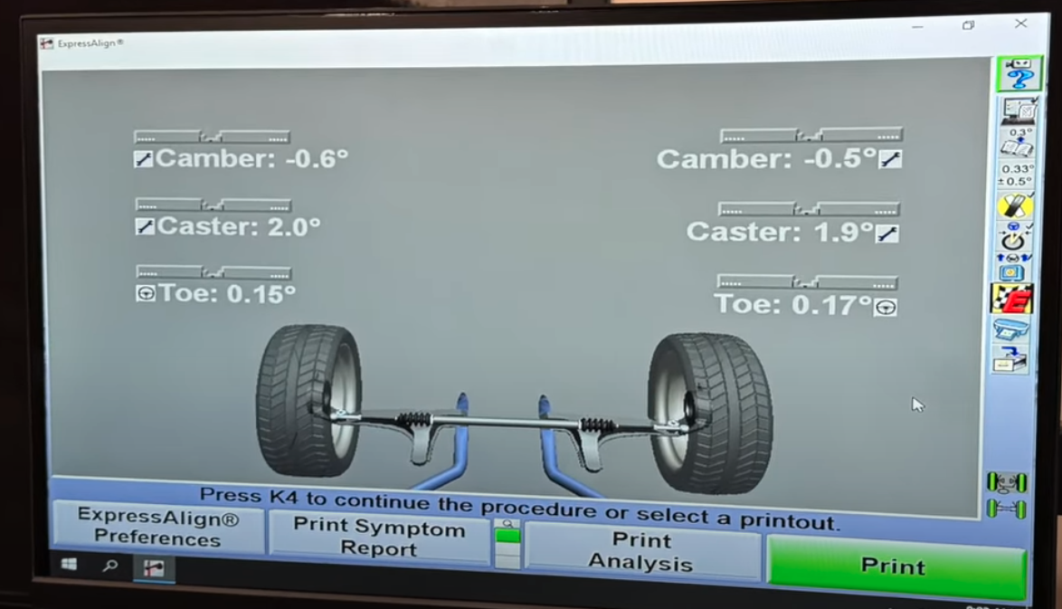

It would have been nice if he showed how much caster his Grenadier was running when he initially put it on the rack. If the factory alignment specification is 2 degrees, I don't see how this is a "free upgrade". They just set the caster correctly.
I appreciate that Owl is trying to make a name for themselves in the Grenadier community by making helpful recommendations, but I don't see "make sure your car is aligned to factory specs" as groundbreaking.
Also, it is not a free upgrade when you are paying a shop for an alignment. Whether or not adjustments take place, there is still the time to get the vehicle on the rack, place the wheel sensors, etc; the vast majority of shops would still charge some amount of labor for that, even if you get it on there and realize you're already at the factory set 2° of caster and don't need to change anything.

It funny that this came out/was posted yesterday, as I was simultaneously hanging in my local shop yesterday for the new tires to be installed and to get an alignment (Not because of the new tires obviously, but because many members have mentioned these vehicles coming from the factory slightly out of spec). They also centered my steering wheel as it was notched slightly to the left when driving straight down the road (But I feel the crown of the road may have been contributing)
I did not take a picture of the alignment machine screen, but these were my pre and post alignment specs:
Pre Alignment
Camber: -0.5 (L) & -0.5 (R)
Caster: +1.2 (L) & +1.5 (R)
Toe: +0.28 (L) & +0.12 (R)
Post Alignment
Caster: +2.0 (L) & +2.0 (R)
Toe: +0.10(L) & +0.11 (R)
There wasn't much of a discernible difference in the driving experience (albeit I only had 200 miles under my belt with the factory alignment and KO2s) My steering/handling experience has largely mirrored others in that there is a minor "Dead spot" in the center while driving straight, mine does not wander at speed but minor corrections are required with road undulations, and there is always a bit of an anticipatory component to navigating turns at speed on winding roads. No complaints here, very happy customer thus far.
Have driven 2500 miles so far. At first the car was pulling hard to the left on the highway (over 60). Adjustments were made and things improved - now at highway speeds while coasting the car drives straight. If I accelerate it darts hard to the left.
Mine does the same. Power on it pulls to the left, power off, goes down straight. It's frustrating but I'm only at 200 miles. I'll call Mossy and see what they say about it.
Yeah - that's odd. I'd start with a check of the alignment.
Definitely alignment issue. Had the same issue on my LC200 after new shocks and a crap alignment from 4wheel parts. On throttle pull one direction, on brake dive in opposite direction.

Recommend a wheel alignment and make sure to get the caster set to factory spec. Mine was "out" and horible, now happy with it.
