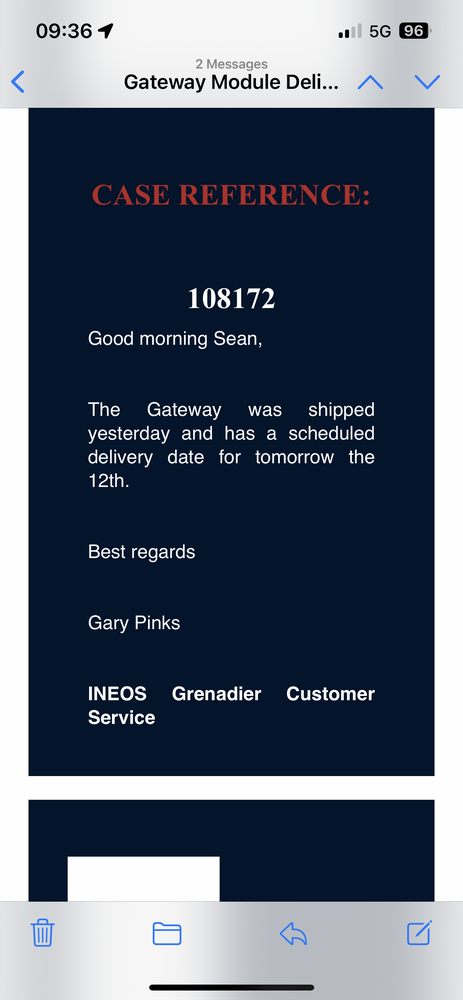

Well I’m still waiting on a replacement Gateway control unit , eight days and counting and the vehicle is stuck at the dealers. Harwoods are chasing every day and it’s supposedly in the post. How long would it take to get parts in more remote regions or where Ineos don’t have dealerships? Frustrating 🤬

No it’s not a turn of phrase. Harwoods are as frustrated as I am and have been pushing hard.

Did you ave a gateway error in your info screen? Saw in one of the FB forums that this message came up. I am really worried that this is a potential weak spot in the car.
No my error on the screen was power steering error but caused by faulty gateway control module. Well anyway I hope that’s the cause of the fault and that a new module fixes the problem, otherwise it’s back to the drawing board to diagnose the fault.

I am going to collect today as module has been replaced
