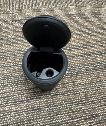

This is all that it comprises - what a letdown!
i didnt even get the lighter socket what a piss take, gonna take it on the chin as my friends and missus just laughed at me when i said a plastic cup costs that much
