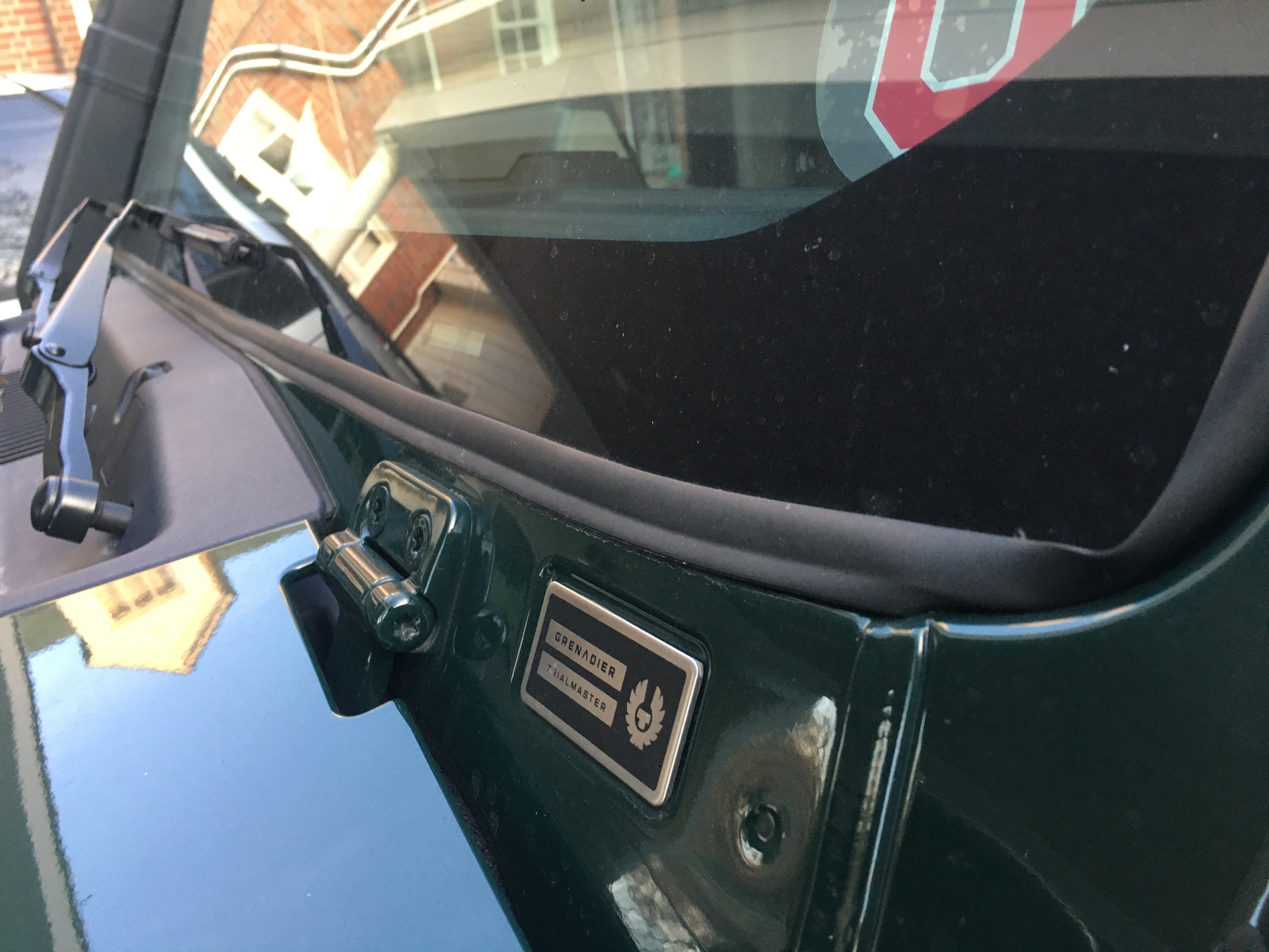

Sad to see so many more cracked windshields. This was my preventative measure and so far so good.
So I bought this rubber molding on Amazon for $15 and stuck it to the bottom of the windshield. https://www.amazon.com/dp/B0B6ZSCY37/?tag=globalgrena0b-20
There is a theory that small rock fragments flow up our hood and may chip the bottom edge of our windshield and then the high heat from our defroster causes expansion and then a crack. It's not pretty, but functional I hope. This is all I'm going to do in addition to keeping my defroster at 70 degrees whenever I run it.
View attachment 7840688View attachment 7840689
Does it still bother you from an appearance perspective?
I am thinking if I do it, I would ensure the strip extends beyond the glass and then trim it to match the curvature in the corner.. make it look a bit more “stock” looking?
