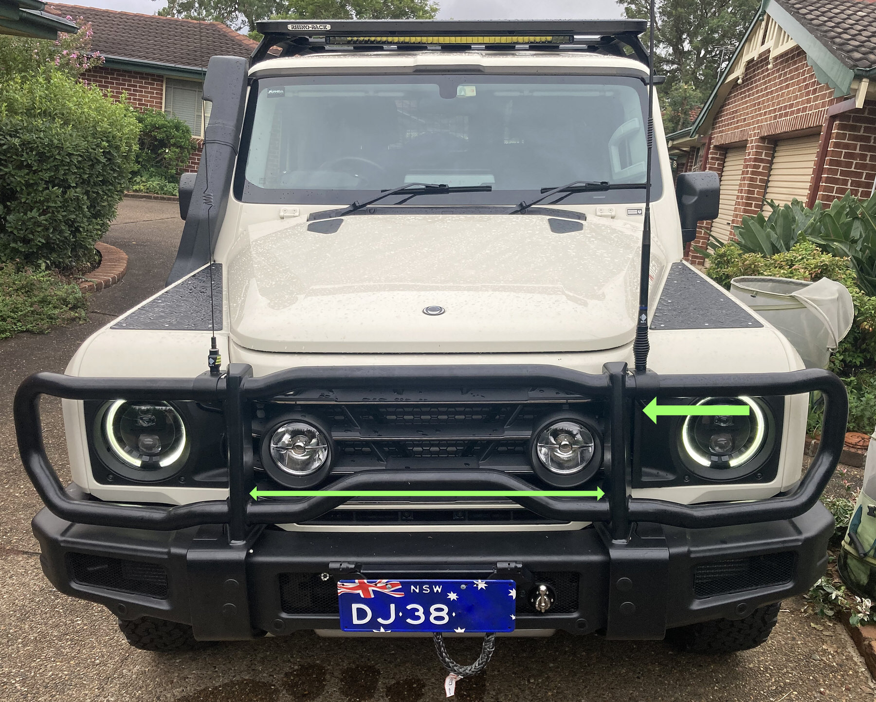

RFI bracket on my Grenadier, arrows just showing where I routed the aerial cables. Looking from the front, left across to right aerial, cables them routed together down through the firewall following John Canny's video, my car is RHD.
full
Note on antenna routing with safari windows:
John Canny doesn't have safari windows. If you have them and go looking for his firewall hole it won't be there. I routed my antenna cable through a small grommet in the airbox, which dropped the cable down behind the glovebox. There's enough room there for my eventual ham antenna too.
