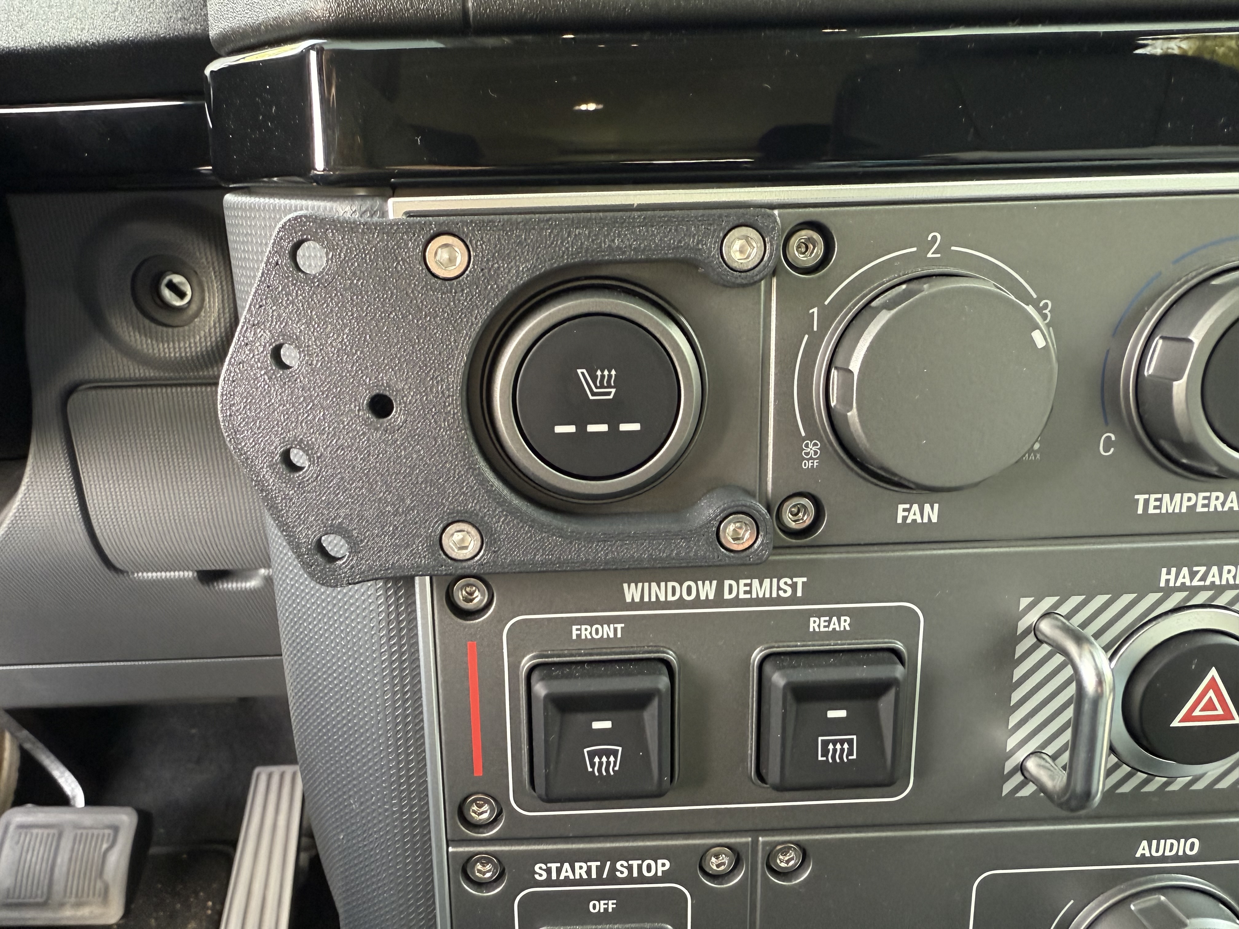

Thanks everyone for all the help - greatly appreciated. It turns out that the hole geometry of the smaller (2 screw hole) RAM mounts perfectly aligns with the holes in the switch panels. So changing using some 20mm machine screws, they fitted perfectly - no panel removal or drilling. These mounts are for (a) iphone 15 Quadlock magnetic charger; (b) iPad running Hema maps; (c) GME CB microphone holder.... or whatever I choose as, with RAM mounts, I can swap stuff around depending on the nature of the trip. See pics.

Great install @SoundEngineer. Just be mindful of the loading on the control panel with using 2 screws for the ram mounts. The outer ones you used just screw through to the panel itself and not the supporting bracket behind. If you take out one of the inner screws next to your mounts you’ll see it’s much longer. The screws on the periphery are short and the one on the bottom right for this mount are the ones which attach to the underlying bracketry.

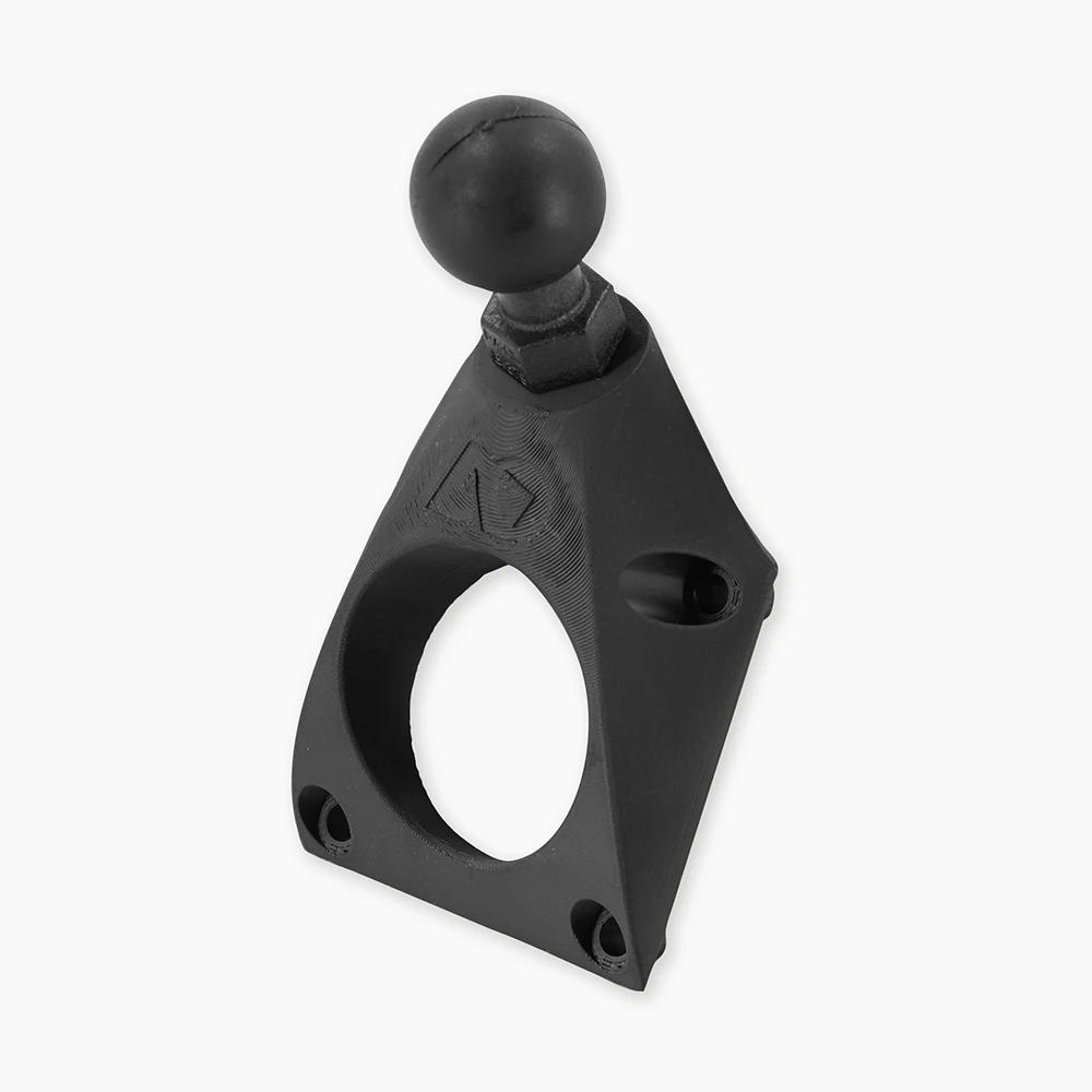

Hi @Stu_Barnes . Can you advise where you got your bracket from, please? (https://www.theineosforum.com/attachments/img_0662-jpeg.7890625/)
