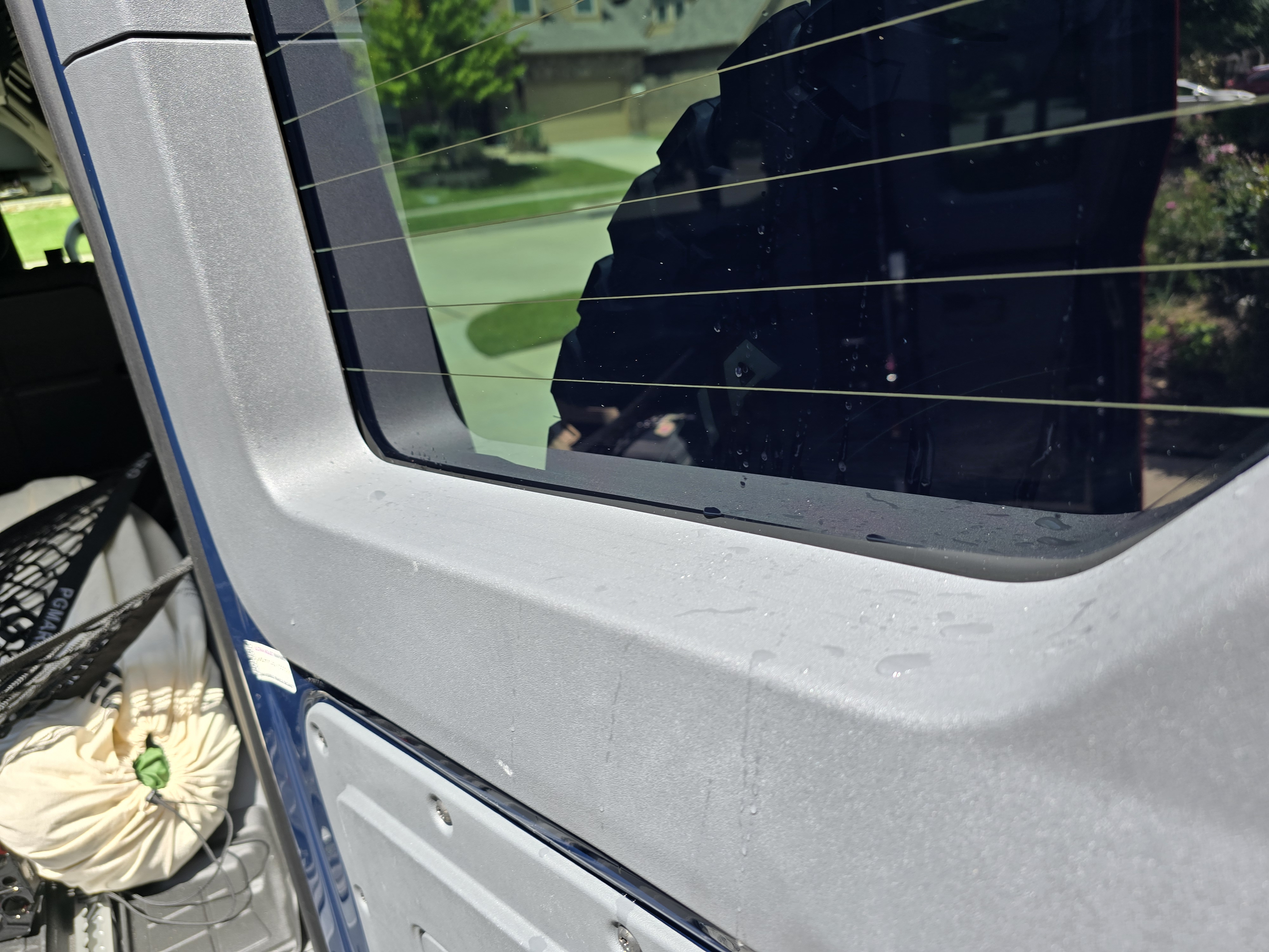

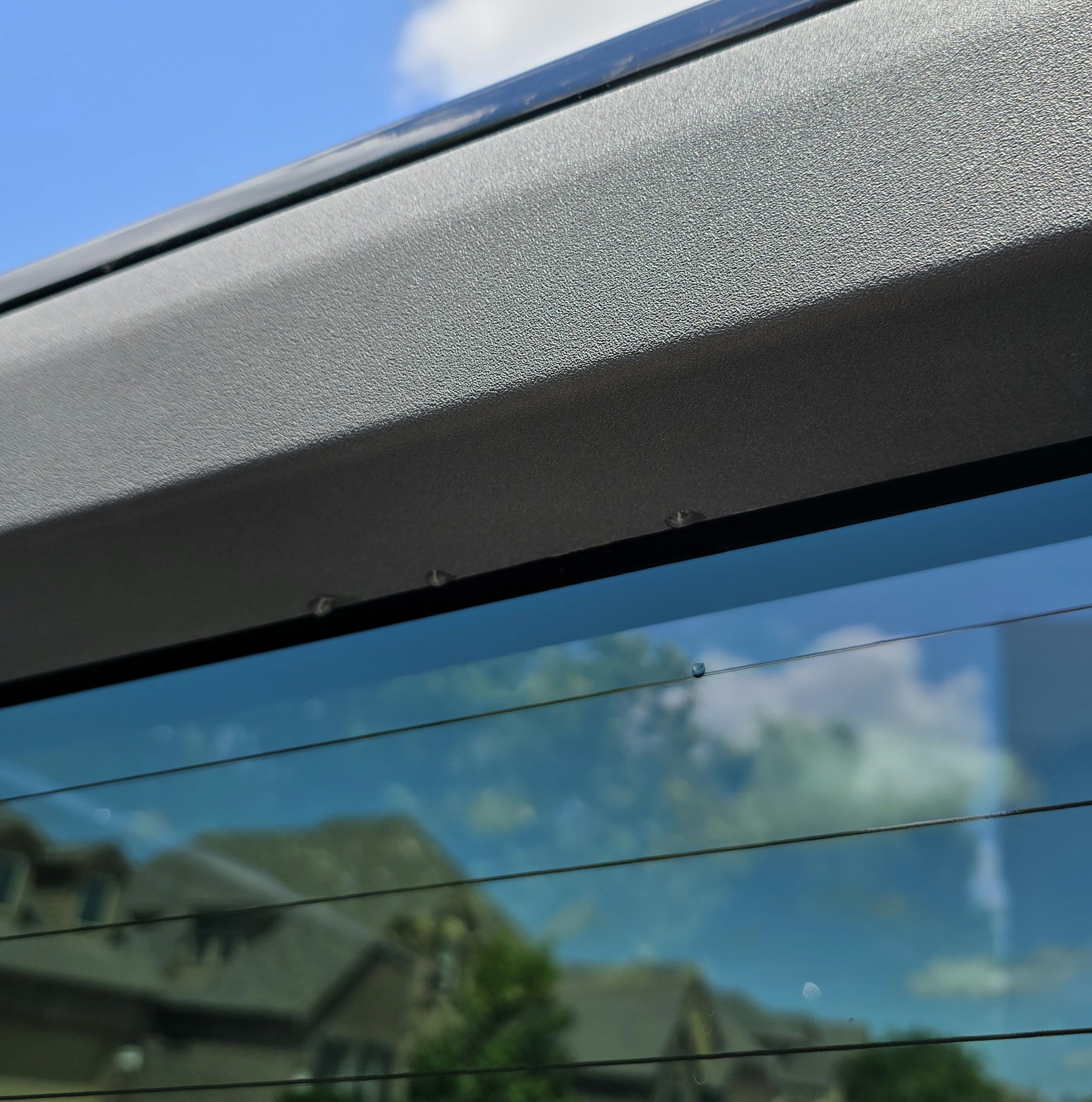

This has happened twice so far... After a storm, I opened the 70% rear door and water streamed from the top of the glass. Trying to figure out where it's coming from. The rubber bung at the top edge of the door is firmly in place.

I wish they put images in the TSB as finding what they're exactly referring to is a PITA. Given the fix time is 0.1 hr I'd like to know what this "roof bar cover" is.

I think that is the outside BAR above the side cargo windows. My independent mechanic said that “behind” the place cover is a hole in the roof that would allow water to drip in. I’ll find out more detail tomorrow.
