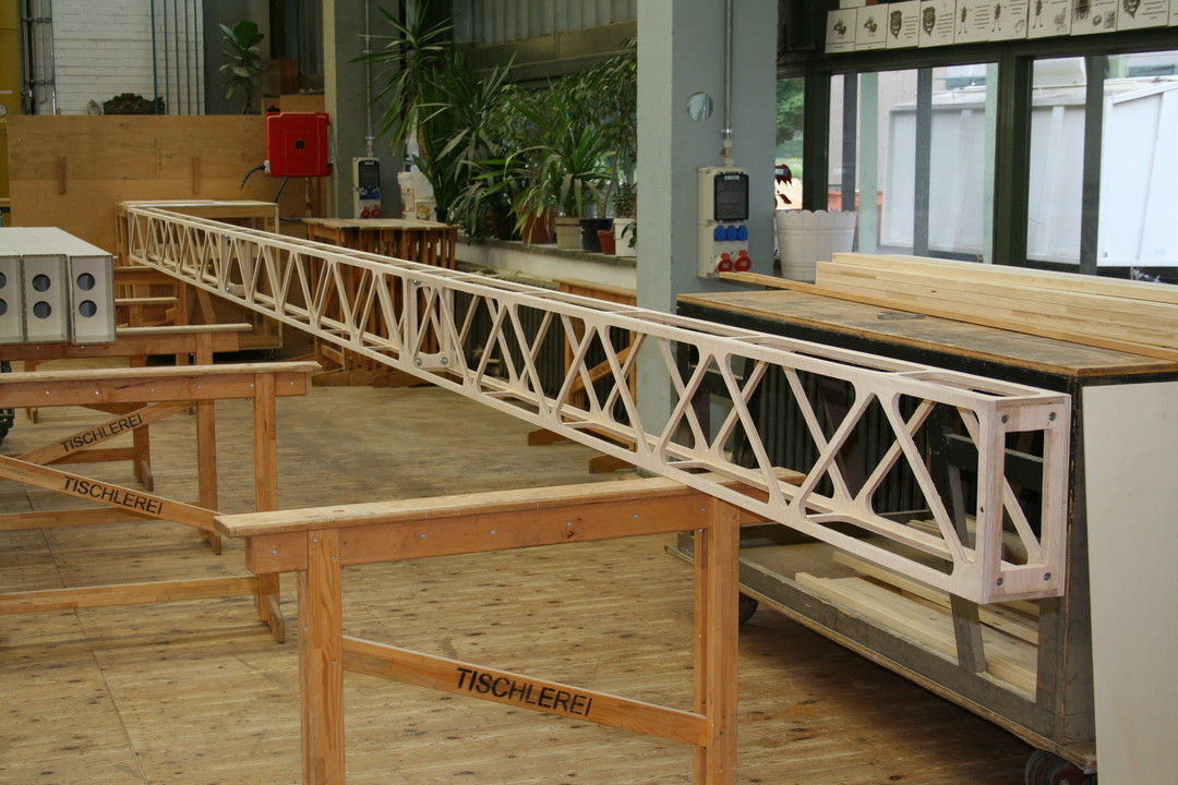

Imagine the beam below at a height of 50 mm. It takes a fretsaw or a handrouter - and time. The strength is just incredible.

Here is a nice website which visualizes the principles of wooden lightweight constructions (although this is for much larger loads).
