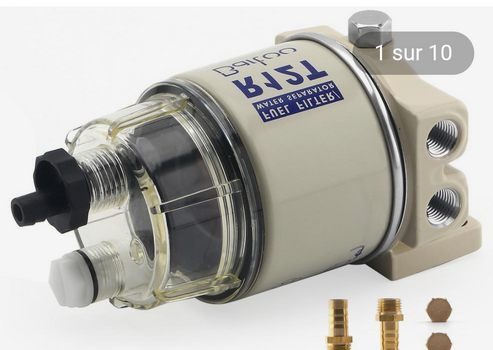

I need some advice in order to prepare my EU spec Diesel Grenadier MY23 for a long overland journey through some countries were somewhat bad Diesel fuel quality is available only.
What I know so far, in some countries (Kenya, NAM, SA) the Diesel is already equipped with an additional Diesel water separator filter from the factory, also without AdBlue and I guess some other parts are different to an EU specced Diesel. I also expect that the engine control software is different as well for those countries. The additional Diesel water separator filter can now be ordered as an option from MY24 on, but I assume we can retrofit this part at an INEOS workshop.
Maybe someone have deeper knowledge what we can do/change so that the Diesel engine can work with those bad quality fuels.
Having the fuel/water separator is the most useful step. Your main enemies are water, particulates (often rust) and algae contamination (including algae do do).

Having the fuel/water separator is the most useful step. Your main enemies are water, particulates (often rust) and algae contamination.

Thanks, Mr. Funnel filter is already on my list. This part is great to clean any fuel from water and debris before you fill it into your Jerry Can or tank!
