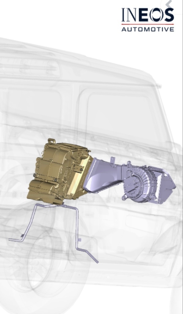

This is the best pic I could get from a dealership

Ineos didnt reinvent the heating. My old car did this just fine, I agree. It’s just that the heating and all the blend doors are now activated by software which is very dumb and slow. Software which boots up the whole car before you even start it. Software that doesn’t shut down after you pulled the key but I guess it’s how modern cars are now.
