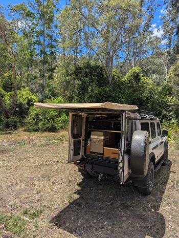

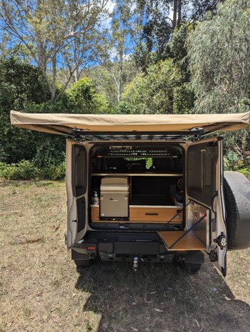

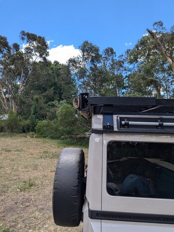

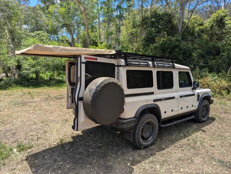

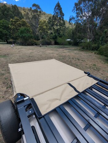

Well there you have it folks. V1 of Hannibal roof rack is complete. What an amazing addition to the Ineos Grenadier, Peter at remotetravel.com.au has delivered the goods!
Sitting at 2000mm long x 1600mm wide and spaced off the roof(not the strips) by 50mm. Unfortunately I can not give weight or price as it the was the first, and final production may differ slightly,
Though I can lift it myself, 2 people minimum needed for install. Fixing it to the gutter did not distort the the gutter itself but the feet did pinch the plastic/rubber strips on the outside of the gutter. (Not a big issue really)
Simple enough to install, very solid like all Hannibal racks and have laid in the centre of the rack at 105kg with no bowing of rack. I highly recommend for those looking for an overland rack. All welded aluminium, strong and lightweight.
Full length is also in development.

any reason you mounted to the gutter and not to the bar mounts?
YIPPE
GG #00286
3:07 AM
Mar 28, 2022
262
661
Hawkesbury, NSW, Australia
Personally Ive seen the options of the bar mounts.... I get it. I do love the Leitner (not the price to get here in Oz) However went with the tried and proven gutter mounts, I've seen them survive with thousands of KMs of corrugations and overlanding. Not to say barmounts would fail but I wonder why ineos had a rack developed using the gutter and not the bar mounts? Also I've had no water ingress so far and so didn't want to run the chance haha. Thus i went for a Hannibal roof rack as I've used before on defenders and knew it would be everything I wanted.
