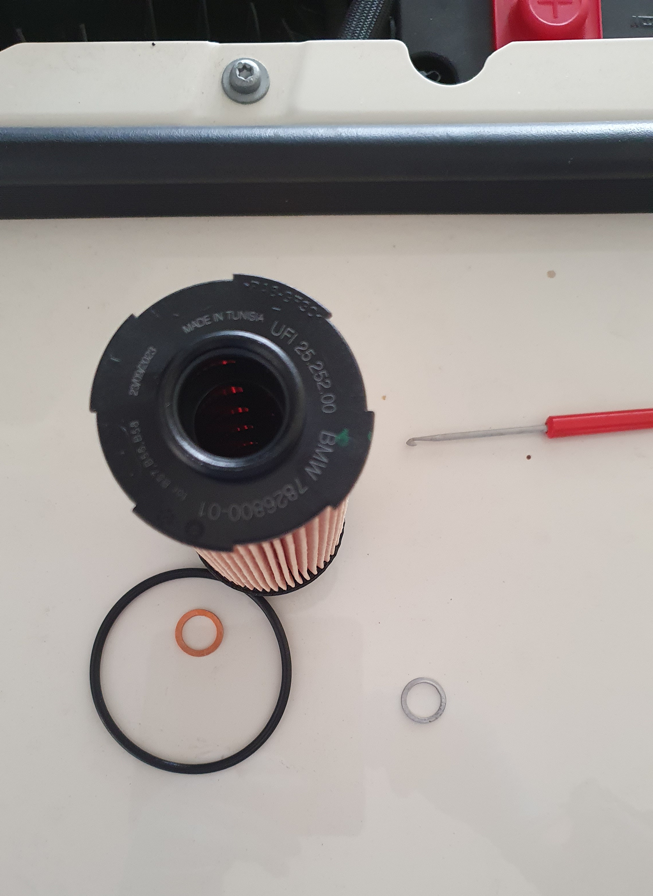

The original crush washer is the alloy one on the right. Just in the process of changing the oil. What a cathartic "Freudian" experience that is!!! After lying under the vehicle and then arising like Lazarus...well let's say the world spins... must be an age thing....that and the blood pressure meds...🤣
Glad you enjoyed getting under the car, I certainly didn't. While there's reasonable clearance, enough to squeeze under, the fronts/sides, and there's a bit more in the centre section, I didn't find it too too pleasant at a mental level, I was looking forward to getting out of a confined space, standing up and having the world spin for me :) Much prefer working under a car on a hoist/ramps/stands!
Your filter photo almost asks more questions than it does provide answers though! I've been through the thread @TheDocAUS posted regarding filters plenty of times and your filter appears to have come from Tunisia (EU market) while AUS ones apparently come from Mexico. I don't know where the filter in my car came from (never saw it) or where BMW replacements in AUS are manufactured but the Ryco I have was made in Bulgaria.
Is there a mix of filters getting delivered to AUS (both factory fitted and as replacements)? And is there a mix of crush washers being used, noting the OEM BMW filter kits come with copper ones?
FYI, my car was one of the first to be delivered to AUS, 2nd customer car in SA I believe, back in AUG last year (though had to wait until early SEP for handover while waiting on side repeater lights) so maybe there's some variation?
