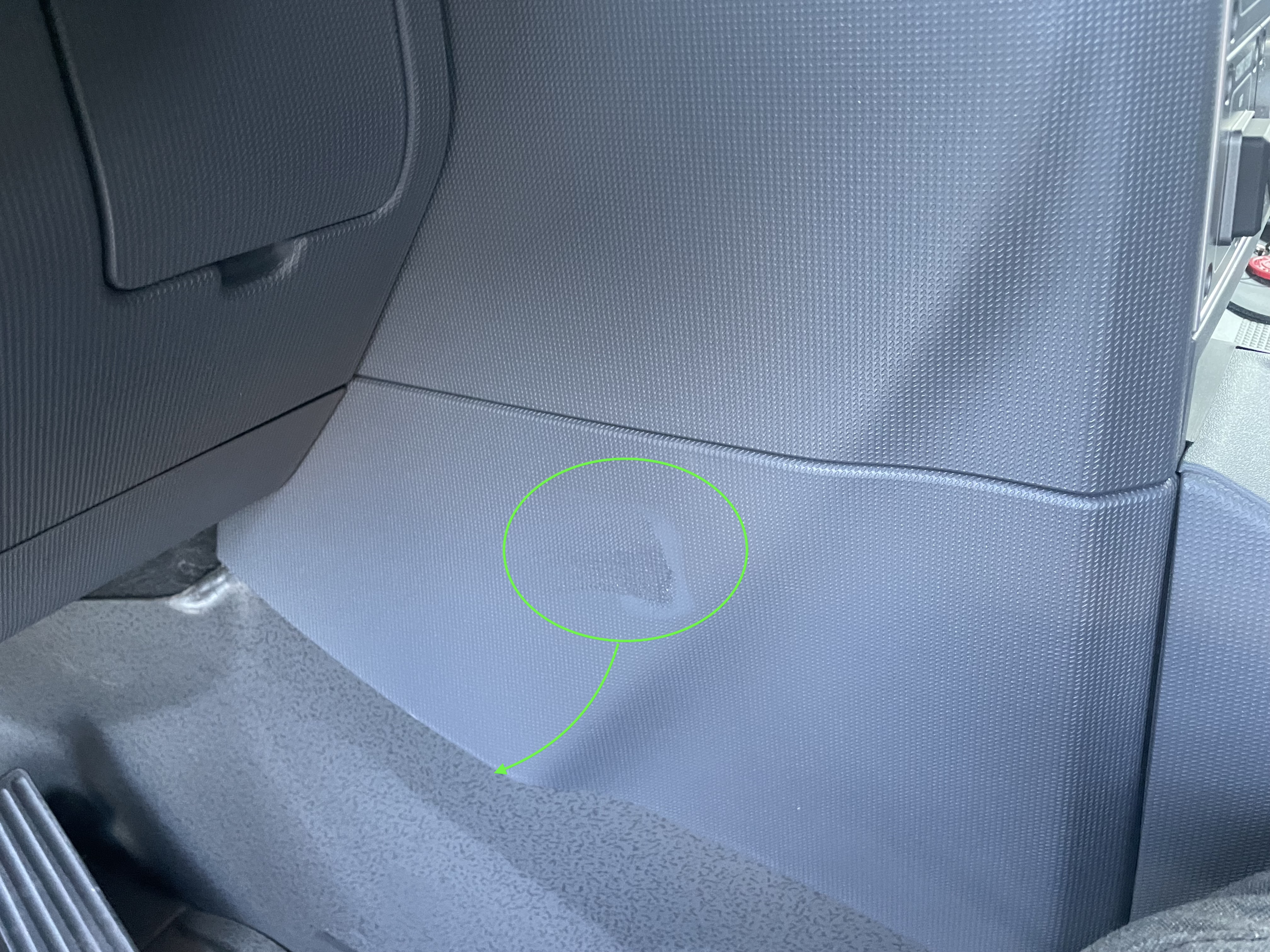

Hell mine leaks when it not raining. Wondered how I kept spilling water or something on my right foot when I wasn't even drinking anything. Must be some more of that Ineos magic like the damn speed alert they insist we have. What concerns me is when I look on the dates of these posts and this was known issue / issues a year ago. Long before I took delivery. Guess they did not care to fix pre-delivery. Class act !ago. Long before I took delivery. Guess they did not care to fix pre-delivery
Class Act! lol

I have the same, drops appear only on the floor mat. It did not do this until the heat & humidity arrived in June. It’s on my dealer fix it list.
AC works phenomenally! Tested it out the past few days in 98F and what felt like 100% humidity.

I still get water forming and dripping now even in let humidity 24C outside temp...
The foot well still drips unfortunately even after the latest TSB which involved changing to an updated micro/cabin filter.
This will not fix the issue. I'm of the view it's straight up condensate forming on the AC duct where insulation is not present and dripping straight down the centre console plastics on to my feet. There are a few threads on this and findings I thought suggested this was the issue and the fix requires a removal of dash plastics to give access to AC ducting...
I have a thought that the reason why there are drips is because the HVAC doesn’t know what it’s doing. It’s where cold air from the outside hits the heated warm air inside and produces condensation.
What I’m saying is sometimes the HVAC is freezing cold and sometimes it’s hot. This is the most probable cause. Ineos fitted a thicker micro filter (latest TSB) to restrict the cold air. It kinda works, the drips are less but it’s still there.
As Tom says, having it on recirculate is where the same temperature is recirculating in the cabin. Therefore no temperature change, no condensation.
Ineos really need to fix the actuators/flaps inside the HVAC. I’m convinced sometimes it’s stuck in between footwell and face. It can sometimes blow warm air to your face and cold air to your feet. This may explain the condensation.

Can everyone test my theory to see if it drips. So far working for me.
Fan speed 1 or 2 (manual mode). Choose a mode which blows the same temperature out of both vents. (Ie windscreen/feet). Check at the end of the journey if there is any drips. Basically same temperature air (no hot/cold), so no condensation forming on the outside of the pipes equals no drips.
Class Act! lol
. View attachment 7862660
same thing for me.
using the air conditioning I found a few drops of water on the mat as in the photo.
Saturday I was in the mountains all day <20°c and I had no water. upon returning home after several hours >35°c I noticed that humidity was created on a plastic cover. this will surely condense and fall onto the mat.
I think better thermal insulation could solve the problem.
