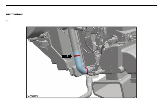

Hi.
I have been having ongoing issues with water coming into the passenger footwell from the aircon. My car has been back to the dealers many times for this - but yesterday I was informed about a factory recall.
See attached FYI.
I hope this helps.
Cheers
