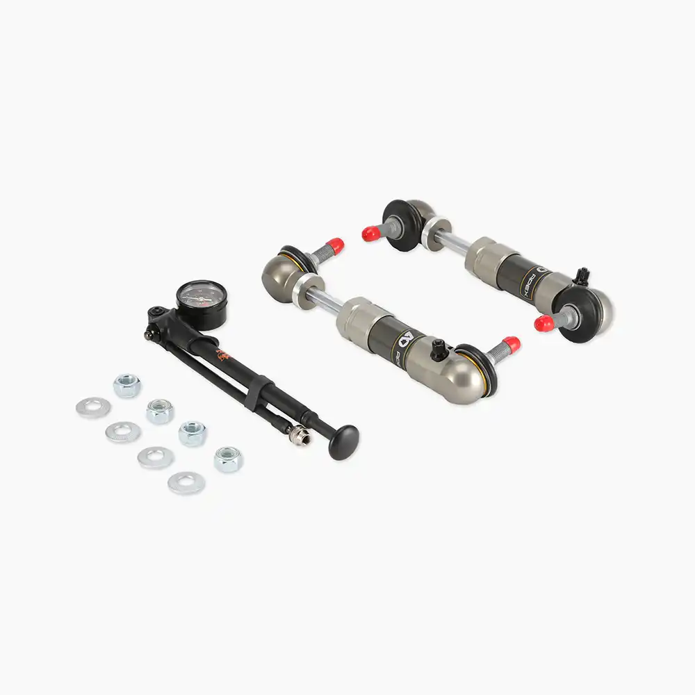

I figured ultimately i would get either the metalcloak sway bar disconnect or the airlynx from agile offroad for disconnecting the swaybars when offroad.
I think i like the idea of the airlynx a lot, seems like with a stiffer swaybar you get a decent amount of ability to dial in both on-road and offroad characteristics with that approach.
I haven't seen the airlynx myself but what i hope to avoid is having to lay under the car and pump air into the swaybars after driving offroad. especially if i'm driving in mud and yuck... On one of the agile videos it looked like they snaked a hose up to the engine bay for the front airlynx. Not sure about the rear. Its probably one of the things i'd like to see in person before committing.

Came across the Agile Apex AirLYNX Disconnects - which appear to allow you to leave connected and only adjust the air pressure. But - they say they are for the REAR. They don't state FRONT, which is all I'm after.
Has anyone tried these out yet? And are they only for the rear or will they work for the front? I did send Agile an email this morning asking for clarification, but also curious if anyone here has any experience with these?
