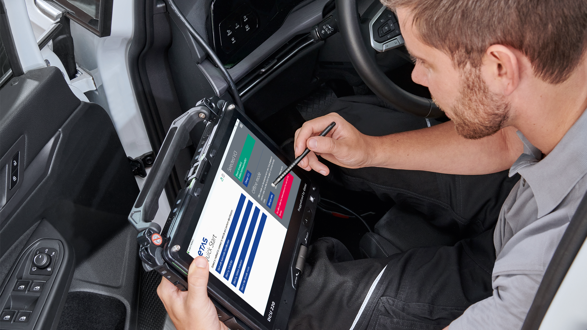

Today I had occasion to play with a Bosch Diagnostic kit called ESI[tronic] at work, which is Bosch's after-market diagnostic system.
The kit included an DCU100 rugged tablet / a KTS525 interface module and various cables to plug into the vehicle and the ESI software on the tablet. From what I can work out this gear is a few years old.
We use it for heavy vehicles - unfortunately there was no license to diagnose passenger vehicles.
I thought I would ask some questions on the Bosch website and got some answers pretty quickly. They confirmed that:
- The Ineos Grade-X platform is available to dealers only - not the general public.
- Bosch's ESI[tronic] software (Bosch aftermarket diagnotic software) does cover Ineos Grenadier.
If you scroll down the linked page to "more information" it lists the features of the individual software packages including these items - diagnosis of modules / manuals / connected repair / circuit diagrams/maintenance schedules and information.
Couldn't find solid pricing but it seems like a new diagnostic interface + software licences will run to at least a few thousand $AUD. So not really an affordable enthusiast/home solution. But I guess that means that you probably can take your Grenadier to most Bosch service shops who I guess would already have the software and hardware required.
Does anyone with one of the issues which currently only the dealer can fix (airbag light from not following the battery disconnect process / service indicator reset) want to test the theory and try to get a Bosch service place to fix it?

ESI[tronic] seems correct. Screenshot from Bosch website:
