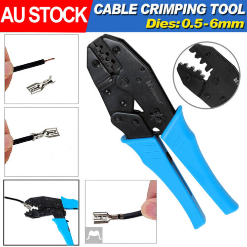

If you're using the open barrel pins... the below tool works well for the few you might be doing. If I was an auto sparky I'd likely be using closed and have all the various closed barrel tool sizes required but for the 4 or 5 I've done this sufficed.... does dt and dtp
