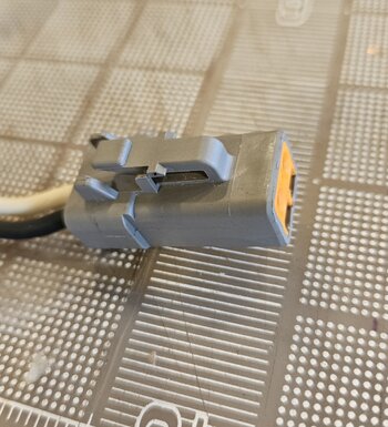

So I've been doing a bit of electrical work that required using Deutsch connectors. I used the pack from agile off-road which worked great. In a pinch I needed some additional connectors both dt and dtp style. I went to Amazon...
I really can't recommend the jready brand of connectors, just not that great quality IMHO. The original brand connectors are far superior.

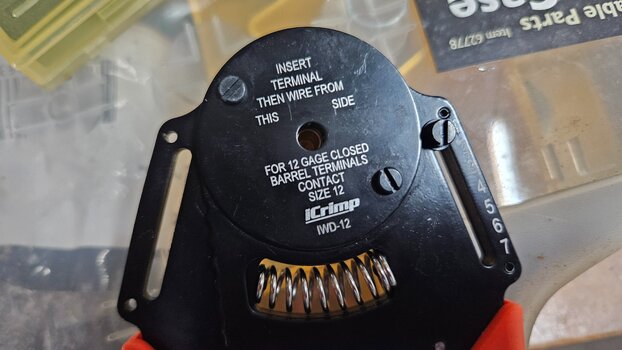

What crimper are you using for the ‘solid barrel’ type DTP Connectors (my local shop could not work with them and so I had to source the ‘open barrel’ type that are much easier to use)?
I use this one
I use both iwd-12 (for the dtp connectors that agile ships this is perfect).
For dt which is a smaller connector often used on lightbars I use the iwd-16.
Both are really good quality and super easy to use.

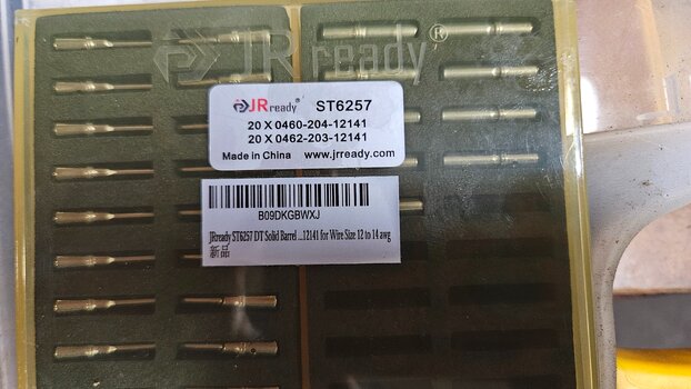

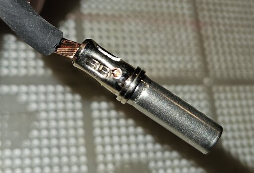

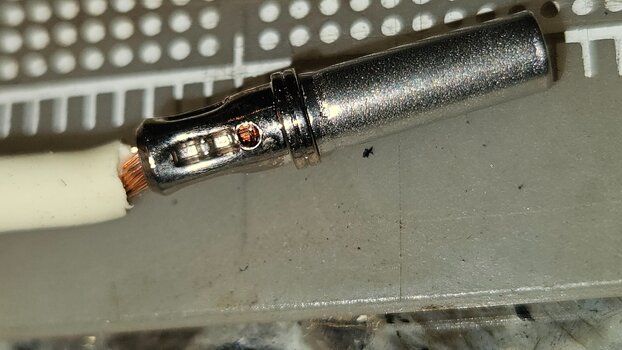

Make sure you order the crimp style connector that requires the special crimping tool. The other style of connector is not great IMHO. Zoom in on the connector pin in this kit, this is best avoided
This style pin is used with the crimper.
This brand isn't very good though...

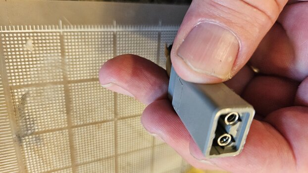

What did you not like about jready? I have a unopened box in the basement to use on the QM
The fit isn't that great. Compared to original it's just not the same level of quality. I have serious doubts that the jready actually will be ip68 water proof. I think these will degrade in real life fast.
