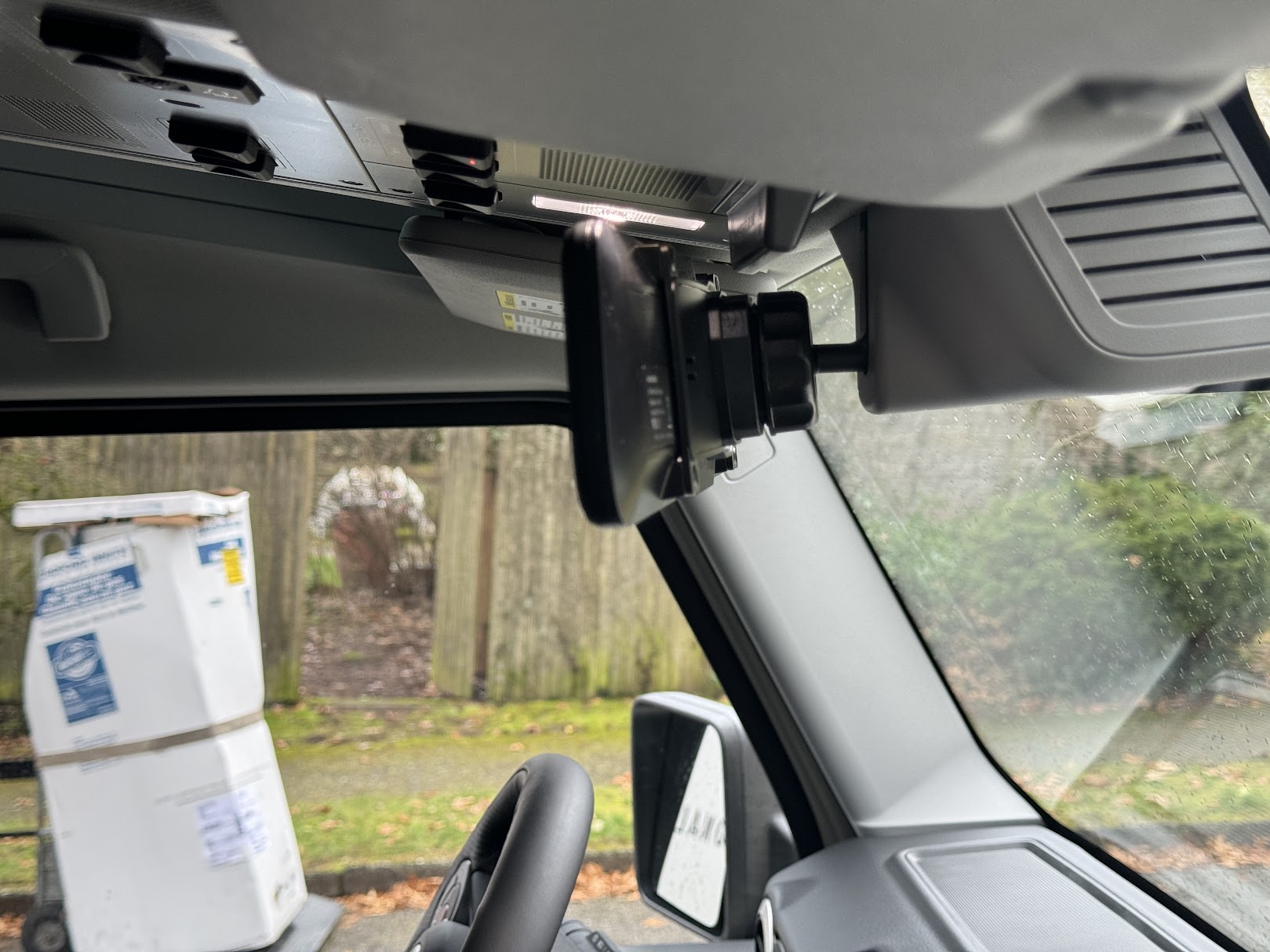

Started the wolfbox G900 install. Have the mirror head mounted with ball adapters and a backplate from Amazon. Had to grab the kids from school so I'll do the wiring later this week. The rearview mirror function without power is a little dim, and the power button rattles at idle. There's a little vibration when you drive too, which I'll have to get to. I will probably run it with the wires exposed for a bit to see if I can tolerate the vibrations, otherwise I'll unmount it until a better mounting solution comes along.
The stock retaining ring is easily popped off with a thin screwdriver then the mirror just pulls straight off. You'll need a 16mm ball socket to Wolfbox adapter setup to get it mounted like this.
Where did you get the "16mm ball socket to Wolfbox adapter"? I have the Wolfbox mount, but have been unsuccessful finding the correct ball adapter.
Same ones as @terdrocket. There's a link in the post you quoted. I don't know what I will do with the other sockets so I wish you could just get what you need.
