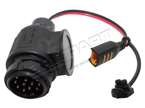

I like @DCPU idea, charge, with a smart charger through the live pin on the 13 socket. I'm going to make one up while waiting.
My version of an idea from DCPU in which I can use my Optimate battery tenders. I saw similar on a caravan thread from someone with 7000 contributions over the years. Although calling himself Griff. Something about it was very DCPU. 🤔

Hello, small question to the electric experts. Is it possible to hook up a charger or on of those folding solar panels with Pwm controller on a aux outlet at the roof? Of course with the battery switch turned on. I’m looking for a easy solution to support the battery while I’m camping and the fridge is running.
Hello, small question to the electric experts. Is it possible to hook up a charger or on of those folding solar panels with Pwm controller on a aux outlet at the roof? Of course with the battery switch turned on. I’m looking for an easy solution to support the battery while I’m camping and the fridge is running.
I have done so using the tow hitch socket

I’ve seen this option, but I would like it more to use the outlets on the roof cause I like to put the solar panel on the roof while using it and in this case the cable could be much shorter.
But thanks for pointing out the hitch socket option. This is my plan B 😉
