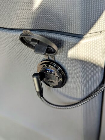

Powerwerx makes good quality 12V->USB chargers both panel mount and surface mount.
Powerwerx USB Chargers
Excellent! Thank you. This surface mount appears to be a good choice if I do not want to alter the panel.
It appears that I can just wire it directly with a 12 AWG wire into the Deutsch DTP connector. Do you happen to know if that’s correct? Not sure if I need some sort of converter or fuse in between the two…

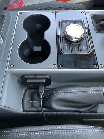

Did you make the socket mount box in front of the gear and transfer case lever's yourself or purchase somewhere?
My son 3D printed the case and I bought the insert with the sockets from
Ebay
