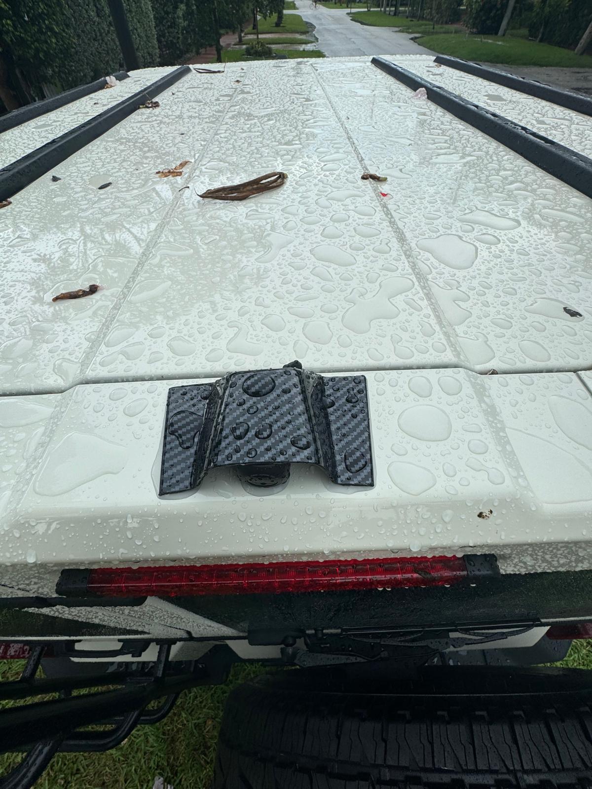

I just installed a G930, for the rear camera I went through the top edge of the headrests along the door panels and weather stripping on the jams. I then went under a trim piece which has to get unscrewed and to the roof without making any holes. Figure I'd share since we all basically have the same make and model lol. I used the double sided tape to hold it down but I was worried that it would fly off in a car wash. For some odd reason this part popped up on amazon for a corvette
https://www.amazon.com/dp/B0CLNWVLS2?tag=globalgrena0b-20
I purchased it but it wouldn't fit the cars curves exactly, maybe someone else here would know a closer fit. I ended up trimming it and it works great and now I am not worried about the camera popping off and I didnt make on hole in my car for this entire instal. I know they sell license plate brackets but I wanted the camera on the roof as I get a much better viewing angle that way. Maybe someone can 3d print perfect fit covers! FYI I couldn't find any other better matching colors for this, but you really barely see it anyway. It actually looks like its OEM and matches the black strips on the roof unless you come really close and focus on it.

Did you remove the plastic parts on which your camera was mounted to lay the cable there? If so, do you have pictures of the process or do you know how to remove this cover above the breaking light?
Cheers, Inky_black
When you open the back doors along the roof line there are two or 3 panels that make up the corner. I loosened the screws on the outer ones and removed the center one where the camera sits. I passed the wire under it and then screwed them back down. They are basically corner pieces for the roof and back door jamb. I did remove the camera off the bracket it came on when I mounted it. Here are some pictures.
