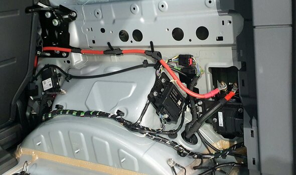

I wonder how easy it is to tie into that wiring and use it for a 2000w inverter in the back instead.
Quite easy. The Ext4 (500A) overhead switch controls a solenoid fitted in the right rear corner under the trim. The solenoid and wiring are visible in this pic. There is a positive feed from the solenoid through the RH wheel arch to the NATO socket. The negative side of the NATO socket uses an earth return.
It would not be difficult to pick off power at the output side of the solenoid for other purposes like an inverter. The circuit is fused at 350A as noted above.
