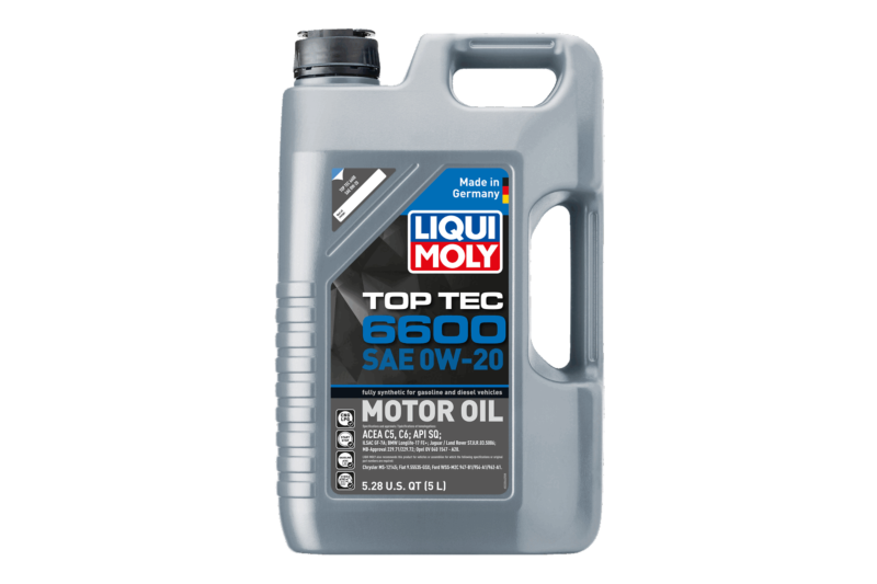

This wasn’t mentioned yet so going to share with the group as I just completed my break-in oil change yesterday (2.2k mls) - Liqui Moly 6600 0w-20 is fully compliant and BMW approved for use in the B58. I don’t want to get into the oil weight debate (20/30/40/50), but this is the exact oil spec and I have used their oil in many cars for years with great results on new to very high mileage vehicles. We all have a GPF so you can’t really use some of the other specs in the long run.

LM is a mid-tier oil. Spends more money on advertising. That oil appears to have a rather low TBN and high sodium content based on this thread and confirms other reports I’ve read.
