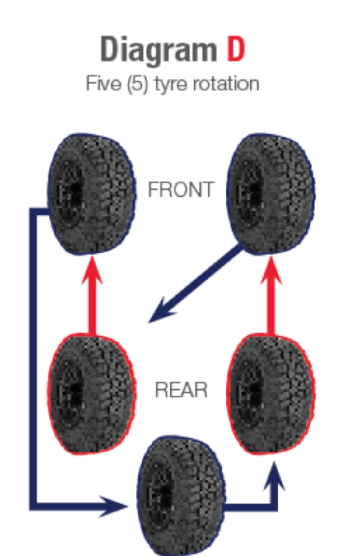

I do the 5-tire, rearward cross on all my 4x vehicles.
my standard 5 tyre rotation around 5k miles
