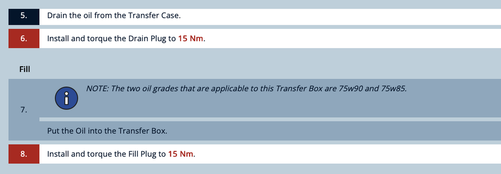

Is there anyone with Ineos Service Manual access who could look up and transpose the general procedure and parameters (temperature, etc.) to the forums here, for a proper Transfer Case oil change?
The workshop manual is no help here.
In short: Drain the oil and refill it. Tighten the plugs to 15 Nm.
There are no instructions on how to drain and refill the oil from the radiator. Inquiries with the dealer regarding the procedure and the required fill quantities were also unclear.
Thanks @Greasemonkey! this is at least helpful to see, that they don't care enough to have a dedicated procedure, perhaps we'll figure something out soon.
Sounds like the best procedure is as you've described previously: measure the drain volume, fill that volume back in at approximately the same temperature window. Check fill level after driving and then change (and sample) regularly.
I'll likely do this service on the same cadence with my differentials 20,000 km (~12,000 miles) or earlier, to cycle new fluid through consistently. I did this on my first T-case oil change and have seen nominal/good performance since.
