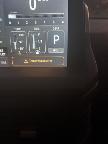

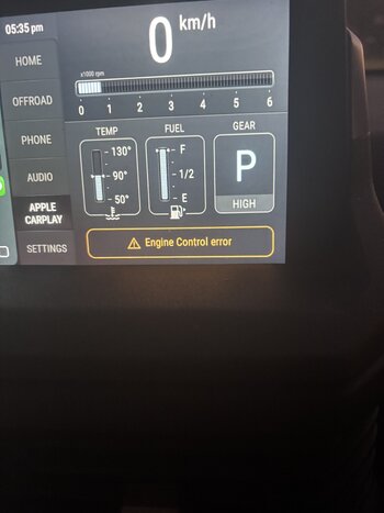

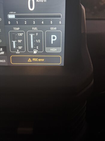

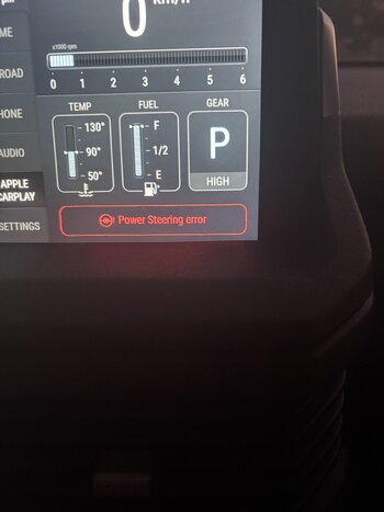

After about 5 to 7 min of highway driving I am getting the following warning lights.
1. Downhill assist
2. Uphill assist
3. No ECS
4. Reduced braking
Any idea what may be causing this? Any help is appreciated. TY

Check your battery voltage.
I have had the same warnings when battery charge below 20%
