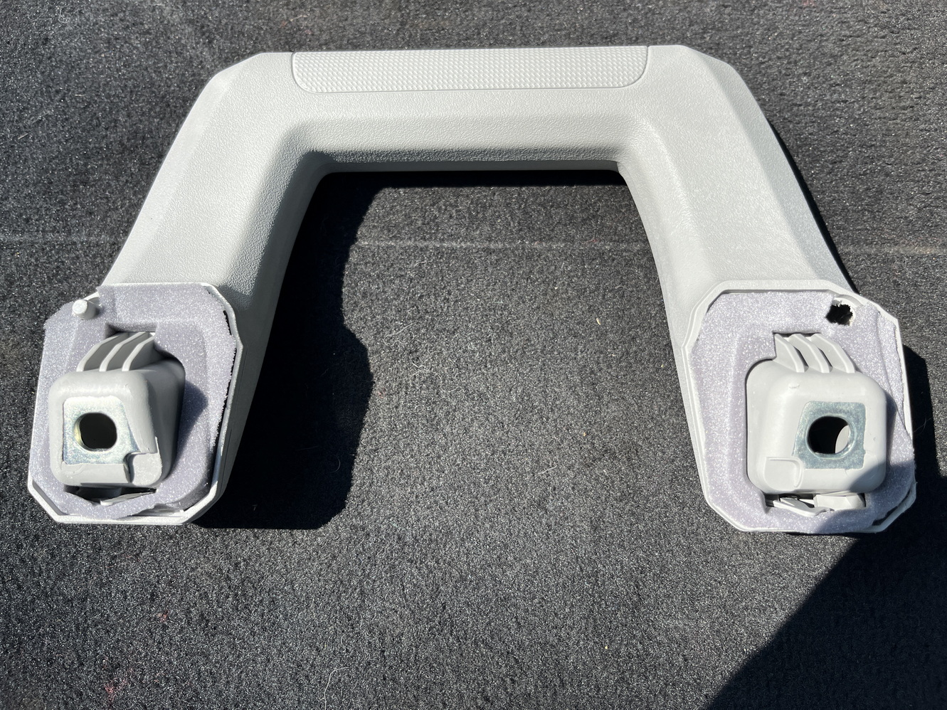

As the LHD grab handle for the driver seems really important to some of you. I give some hints here:
A-pillar left with driver airbag:
A-pillar right with passenger airbag:
The trim from the passenger side. (unsure if the metall comes included with the trim):
The handle from the passenger side:
The handle seems interchangeble LHD/RHD.
So to install the handle for the LHD driver you will need:
1x handle
1x A-pillar trim from RHD car.
Take your TX30 tool and keep going at your own risk if you like. I would not.
Be careful workig near any airbag!
Pull fuse/relay/batt terminal if experimenting near airbags!
thanks.
1x handle
Or you can simply cut holes in your A pillar trim and save a bucket load of money, Illustrated with an RHD pillar handle mod:
Post in thread 'Handles'
https://www.theineosforum.com/threads/handles.12414283/post-1333251137
