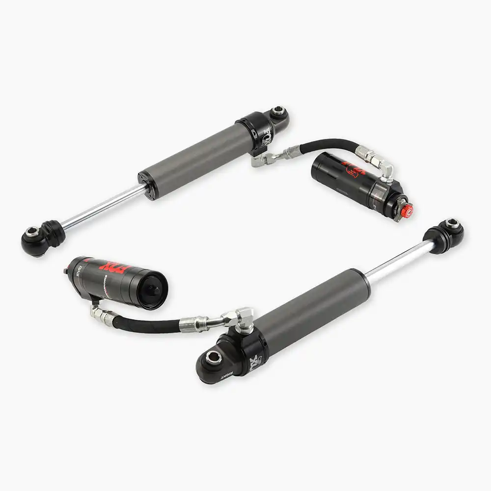

Agile just release the fox shocks. I've watched a bunch of videos where people take apart shocks and they highlight that they like the material choices on the fox shocks better than on the kings so i've been waiting for them. looking forward to the reviews.
Unfortunately, as I expected, but hoped otherwise, Fox delayed these shocks again. Am now being told end of February. Not sure if I'll hold out and wait, with no real confidence that date will be met, or go another direction. Life is short, but I sure would like Agile to handle the entire upgrade.
