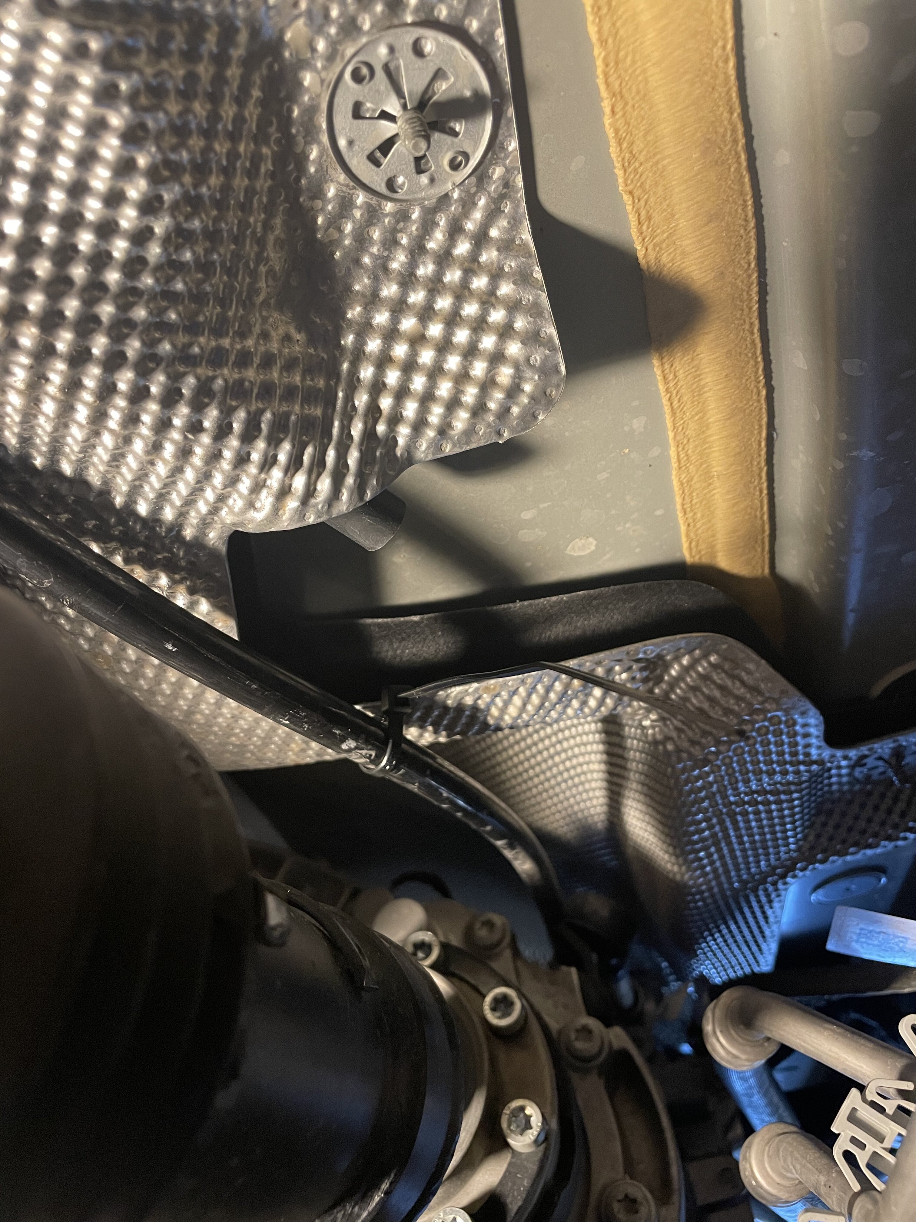

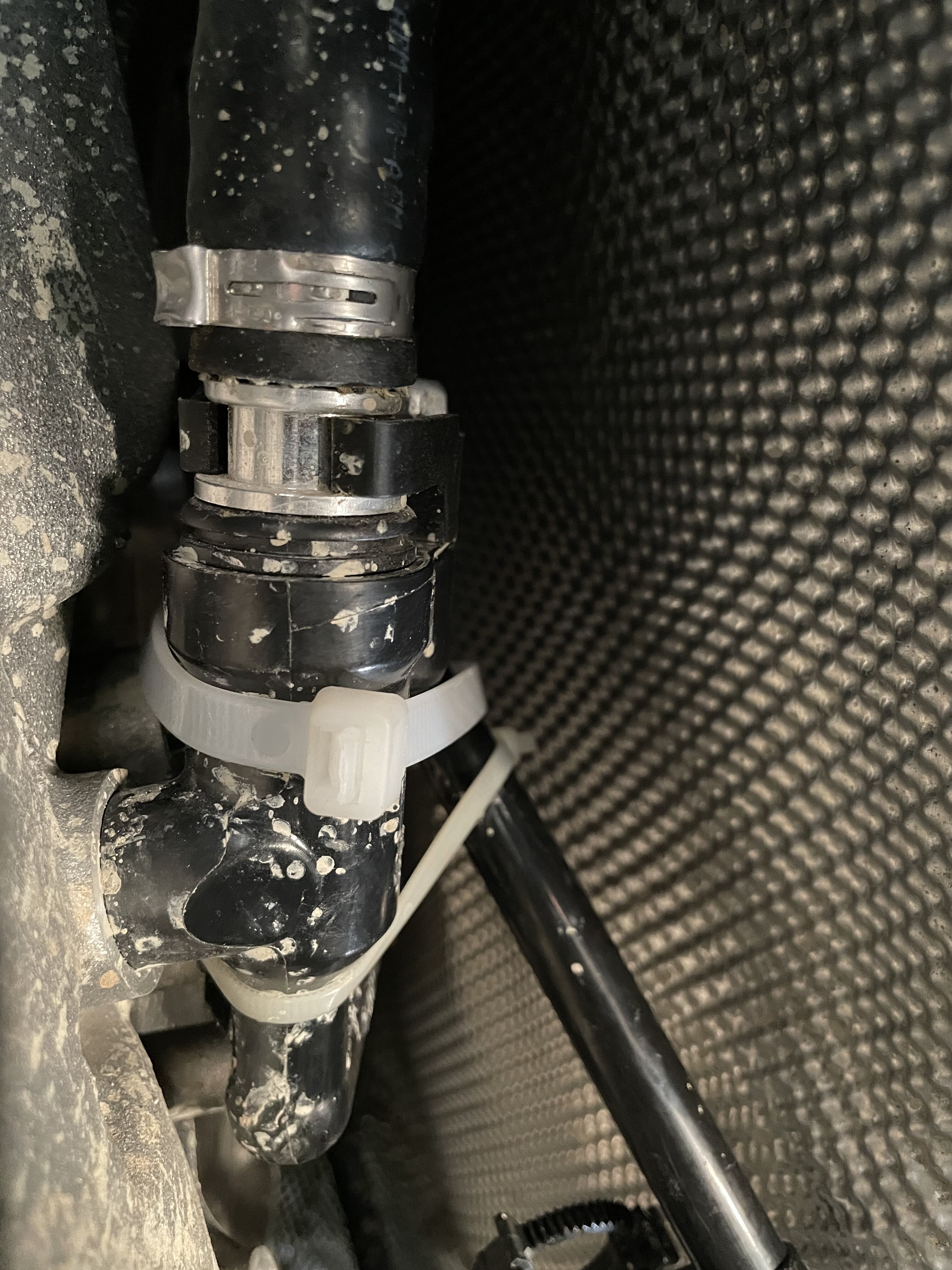

I found that the original plastic cable clamp was broken and no longer close to the heavy black cable above the front driveshaft. I suspect someone at the factory added a thin ‘zip tie’ to help prevent movement of this cable. I have added two ‘ties’ of my own for insurance. That said, the heavy black cable feels well fixed in place and not likely to go anywhere. Please see photos with captions.
(I thought I added captions to each photo but they didn’t seem to turn up here.)
Turns out mine was also zip tied in the same locations
